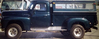

I built an four arm adapter for the end of my shop-crane, (aka cherry picker)The adapter looked like an inverted base for an office chair.
I was able to roll shop crane under the canopy top and lift the canopy off. This was simple and it worked really well, for years. The canopy was bolted down in 8 places.
The canopy went missing on the same day a scrap dealer was picking up scrap. I asked the scrap guy and he said, "Oh Sorry 'bout dat."
I cannot go to a canopy seller, because they do not sell a canopy that fits my R120 International. I built the canopy in my shop to the dimensions of the "R". I had access to a 10 foot Brown Boggs brake in 1988, but, all of that has changed.
