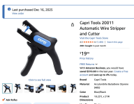

Update - I got considerable negative feedback on the Knipex strippers from another forum / social media.
Ended up buy Capri strippers from Amazon at a fraction of the cost with free shipping.
I'm not a professional - I just mess around with stuff. These might get used 2 - 4 a month. I suspect they will meet my needs okay.

dscheidt
Apr 26, 2017
2,910
I’ve had the capri for a couple years. It’s pretty good. I don’t use it a lot, because I prefer a fixed one when I can use one. I have used them on tiny little wire, and they have saved the day stripping some hard to reach auto wiring, where the free wire was very short

That is what I ran into fixing the snowplow wiring on my Gator. Some of the wires off the winch solenoid were pretty short. I want a pair like these so the next time I come up against that, I'll have the right tool.
Almost certainly rebranded Weicon, great wire stripper 👍
