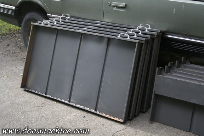

I got a cheap set of Cole architectural drawers several years ago. The outer shell was badly bent, and as note earlier, the drawer slide were just slides, with one nylon roller.
I cut the shell apart, extracted the drawers, stripped off the slides, and cut something like 18" off of each drawer, like so:

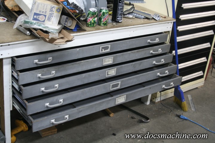

I tacked on a strip of fresh metal on the end, to make a new back wall, and then added new full-extension slides from the local Homey-D.
I built a new frame under my workbench to hang them, and mounted them there:

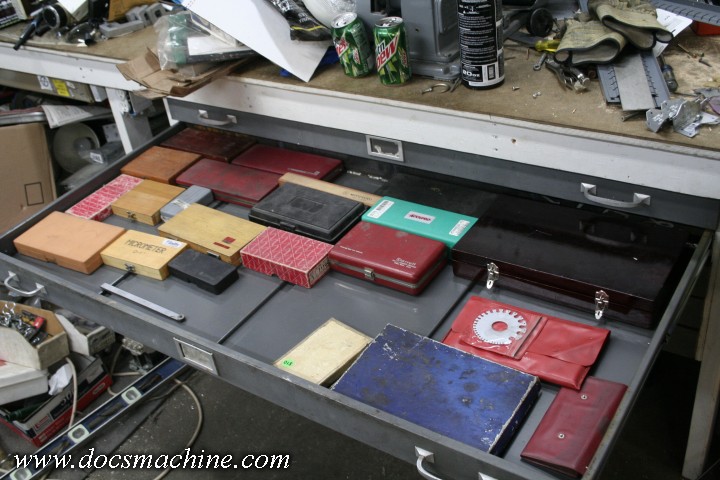

As a machinist, they're awesome for things like measuring tools- this was an early load as I was migrating stuff over, I've got 'em pretty well packed now.
I agree, they're not great all-around drawers. Hell, I have some rubber mallets that won't fit in there. :) But they're great in addition to regular tool drawers. With my cased mics and such as shown, I no longer have to stack them up in a drawer, which means I don't have to keep shifting things around all the time- because naturally, the tool you want is always on the bottom. :)
If I could get more for $75 each, I'd pick up at least three more. I'd love to find another sit of Coles identical to what I have, and run them all the way to the floor.
