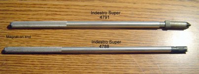

Screw starters that I use for non-magnetic screws.
J.B.
