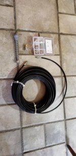

Here's what I've come up with so far, the 1/8" hose is for all the small interior pipe. I'll order another larger hose for exterior pipe. Testing today.

Before retiring in 2014, we used to clean fast food drains every few months. They clogged them up with dropped food and stuff. Had 100 ft hose with a jetter valve and electric pw because used inside the building so no fumes from exhaust. Quieter as well

I have a 1/8" npt trap nozzle ordered, but here's how it's setup for now.
I have a 2000 psi electric pressure washer.

My last clog was 23' down the line from the J under my sink and kinked the auger before I finally got it clear. I don't see the water thing working without at least one forward jet, and even then mostly useful as a after the auger rinse.

First go with the jetter today. I ran 25' down the clothes washing drain and the same through the kitchen sink drain(trap removed) It worked well, this is the nozzle I used it has 3 nozzles on the hext positions.
I have no idea if I just bored a hole through lint/grease or if it cleaned out the pipe diameter?
