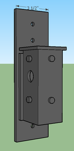

Here’s the whole picture:
It’s a wood workbench built on top of 2 tool cabinets (kinda like a stevo bench)
On top of the cabs will be the grid of 2x4’s on edge, each side will overhang by 4”, the front corners will each have a 4x4 leg, and the back will be lag bolted to studs. On top of the 2x4 grid will be 2 layers of mdf topped with a sacrificial hardboard dropped in a lip of hardwood.
For a vertically mounted receiver, that would give me a depth of just over 5” to mount it in- probably not enough room, and no real good way to reach the hitch pin.
I’m not a welder (yet), but I thought of asking my brother in law to weld a receiver on a plate that I could vertically mounted on the 4x4 post. The problem with that is then I’d need the plate that’s welded on the hitch to be off centered (which may not even be a problem…)
Does that make sense?

I had looked into that exact VersaMount, but it's 6" wide- so too wide for mounting it vertically on a 4x4.
If I were to get one fabricated, it'd probably be a combo of this one and their wall receiver. Kinda like this:
The worry that I have with this option, is that the plate welded to the hitch would have to be off-center like this:
Is having the plate off-centered even a concern?
Thanks!

So I think the Inline Fabrication plates are a no-go for anything other than light vice use.
Since this is my 1st time building my own workbench- what would you guys and gals suggest.
Either the swappable 2x12 boards like this:
Or fabricating a receiver and off-centered plate on a hitch like this:
Thanks for sharing all of your wisdom and advice!!

I think having the plate offset is of little concern if the plate and welds are sufficiently sized. I wouldn’t have any qualms about 3/8 plate with a good hot 6010 initial pass and capped with 7018 as long as it was a 6” vise or smaller.

I have one of mine mounted offset on a vertical receiver tube and have used it extensively (beat the snot out of stuff clamped in it, LOL) works great. I prefer it vertical, all the forces go down onto the bench top instead of onto a horizontal receiver tube.

I think either method you show will work. I have in the past used piece of steel plate. It was bolted through the benchtop and overhung a little bit. The vise was bolted to the steel plate. Less cantilever is better if you’re really gonna do hard work on it.
