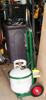

Here's a sample of some of the things that the little ring roller from HF has helped me put together in past couple of years. I have used it on many other projects, these are just the pics I could find easily on my computer this morning.

Mobilized the weed burner;
