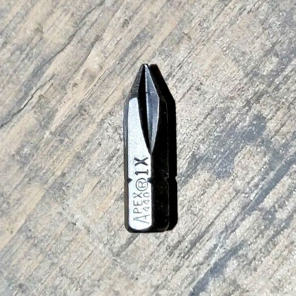

I recently purchased a few Apex Phillips bits and wanted to see the difference between their Limited Clearance and normal versions.
The limited clearance ones look similar to most bits, like a #1 Phillips will have a thinner machined down barrel for the upper part like this:
Apex 446-1X
The "normal" version isn't machined down and just uses the entire width of the 1/4" bit even on a #0 or #1 Phillips bit like this one:
Apex 440-1X
Anyone know the benefits of the latter? Are they stronger in any appreciable way? Is it a cost savings thing to not have to have an additional step to machine it down? Are there actually screws that take #0 or #1 drivers but are wide enough to take those wider bits?
Trying to decide which are better to have.
Thanks!

The name describes the purpose of the "limited clearance" bit. It will also work when you don't have a limited clearance, of course. You are correct to think that machining it down so far will affect the strength.
There are also ACR versions of both.
They are all good to have. What are you working on?
Actually the reduced or limited clearance bits will be machined down more than most bits.
All of these are #2 size but some have different profiles.

that might be something like the Bosch PH2R bits, (#2 reduced). They are Phillips #2 but it is slimmer in profile. These are actually my favorite type of #2 bits. They seem to fit most screws better as they seat deeper into the screw and have a tighter fit.

Ya, the reduced shaft tips seem to fit better in screws, and regular tips only go into the screw recess 1/3 to 1/2 anyways so the rest serves no purpose. Tips always break at the recess entrance so there is little if any increase in strength from all the extra metal in regular bits.

The limited clearance should be fine for your purpose. The limited clearance bits from Apex USA are nice. PB Swiss is nice but pricey. I don't think they make a limited clearance bit though. You might also look at bits from Felo Germany. They're much cheaper than PB Swiss and they do make reduced Phillips.
