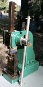

I just restored this arbor press. Obviously an old one based on the brass inventory tag, can anyone identify it? i've had Greenerd arbor presses in the past, I know those, I'm thinking this is a Dake. I also think it was used for cutting chain. I'm going to sell it but I want to be accurate in my description. No markings of any kind.
Color is Hammerite green and bare metal is boiled linseed oil baked.

I don't know Joe, just like vises, that chrome screams import to me.

454, no chrome, just polished by me. Also all bolts are sae not metric.
