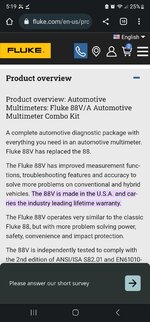

Fluke used to be worth the extra cost. Now, they're just as Chinese as the junk brands.
I bought a Mac-branded Fluke 88 (not 88V) in the middle-1990s. I think I paid $375 for it. I eventually had to replace the leads, so add another $30-ish. Add one hatefully-expensive fuse, some batteries, sales tax... Maybe I've got $500 in the thing altogether.
I've had it 29 years. I've paid $17.25 (probably less) per year of ownership.
About every five or seven years, I have to pull the display out, and run a pencil eraser over the contacts to get all the segments of the display to work at full darkness.
cgrutt
Mar 4, 2016
8,456
That may be true of their lower end meters but certainly not the case with their better meters. For example the 88V is Made in USA and carries lifetime warranty.
ETA from Fluke's website:
