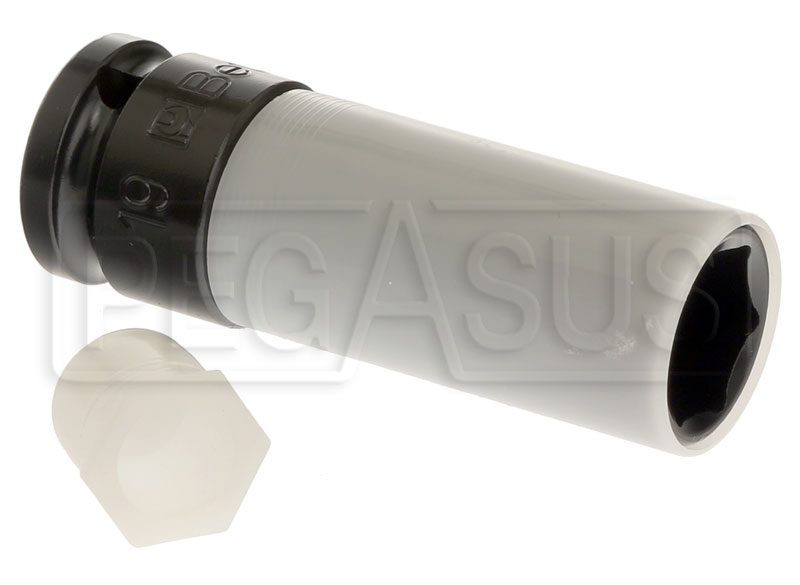

Are no scratch lug nut impact sockets worth buying? I will use my electric 1/2" impact wrench on the no scratch lug nut impact sockets. Will the plastic sleeves come apart?
How is the Astro Pneumatic 5PC NO SCRATCH LUG NUT SET?

I bought these Astro sockets off the SO truck a few months ago, to use with my new Jeep wheels. Only had a chance to use them a few times now but so far they're holding up. I'm using a 90 ft/lb torque stick and then a torque wrench to finish, though.

I've yet to find a custom set of wheels that they fit. The coating normally kills it which is why I bought them in the first place. Go figure :(

Will using an electric impact wrench on these no scratch lug nut impact sockets tear up the plastic inserts inside the sockets? Can you buy replacement outer sleeves?

I was wondering how many wheels these would work on. They barely fit my beadlocks. Sounds like I got lucky! For the price, I don't really care if they ever fit another wheel.

They have a warranty, even though these plastic guards get chewed up.
You drop me a line and you get at least free replacement sleeves or inserts.

I have those sockets.
I can't say for sure if they work or not, but I have never marrd a wheel while using them.
I would rather use them and be safe than use a metal socket and take the risk.

Used those sockets, busted several sets. Not sure why but they didnt hold up and I wasnt using air, older snap on cordless impact.
If you are worried about the finish of the wheels wrap painters blue tape on the socket. Insides that touches the lug-no idea wtf you could do.

I've had the CP ones that are identical for a couple years. They get used every so often and I use them on an air impact. The only thing that's gone wrong for me was the sleeves will fall of, but I just glued them back on. Pretty good value I'd say.

We have a set at work, more often than not you have to take the sleeves off because they wont fit, then they start falling off all the time because they've been on and off so many times.

I have the Harbor Freight set pictured above in post #22. I have only used one of the sockets so far but the Delrin sleeve on half of them have started to split. The nice polished finish probably won't hold up. Other than that they are nice tools and you can easily remove the sleeve exposing a thin wall socket. I needed another 17mm lug nut socket so I just purchased a Sunex thin wall impact socket without the fancy finish or protective sleeve.

i have seen the plastic get chewed up. i simply cover a basic impact socket with painters tape, and it works fine. just replace the tape as needed.

UPDATE: I purchased the Chicago Pneumatic no scratch lug nut impact sockets and they are excellent. The plastic insert falls out but you can glue it down.
