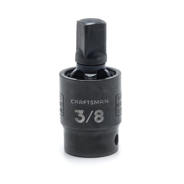

Are pinless impact universal joint socket adapters that much better than standard pin impact universal joint socket adapters? Are they worth the extra cost?
Craftsman Impact Universal Joint, 3/8 in. Drive $15.48
prod_12283895012
Craftsman Pinless Impact Universal Joint Socket Adapter, 3/8 in. Drive $21.99
prod_12271783512

Does any one have both the pin and pinless?
Yes.
The pinless design often has a lower height, and at least to me better rotation. the pinned versions always seem to bind in a certain angled position.
Missing from your pictures is the collar found on most pinned impact swivels. The collar make the impact swivel thicker. Pinless swivels lack the collar and are slightly narrower.
Have I broken a pinned impact swivel? yes. Have I broken a pinless impact swivel, nope. However, I'm sure someone here has.
Is the pinless worth the extra money, that is entirely up to you. To me, yes but, shop around for the best deal.:beer:
