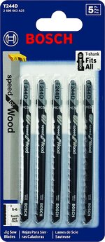

1-1/2" of plywood is no problem for a modern jigsaw. Use a 6tpi blade and set the saw for orbital action. With the right blade and full orbital you can even rip 2x4's.
