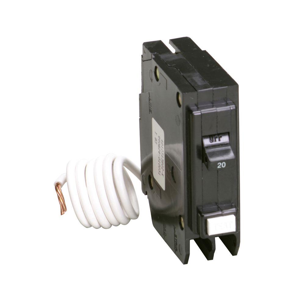

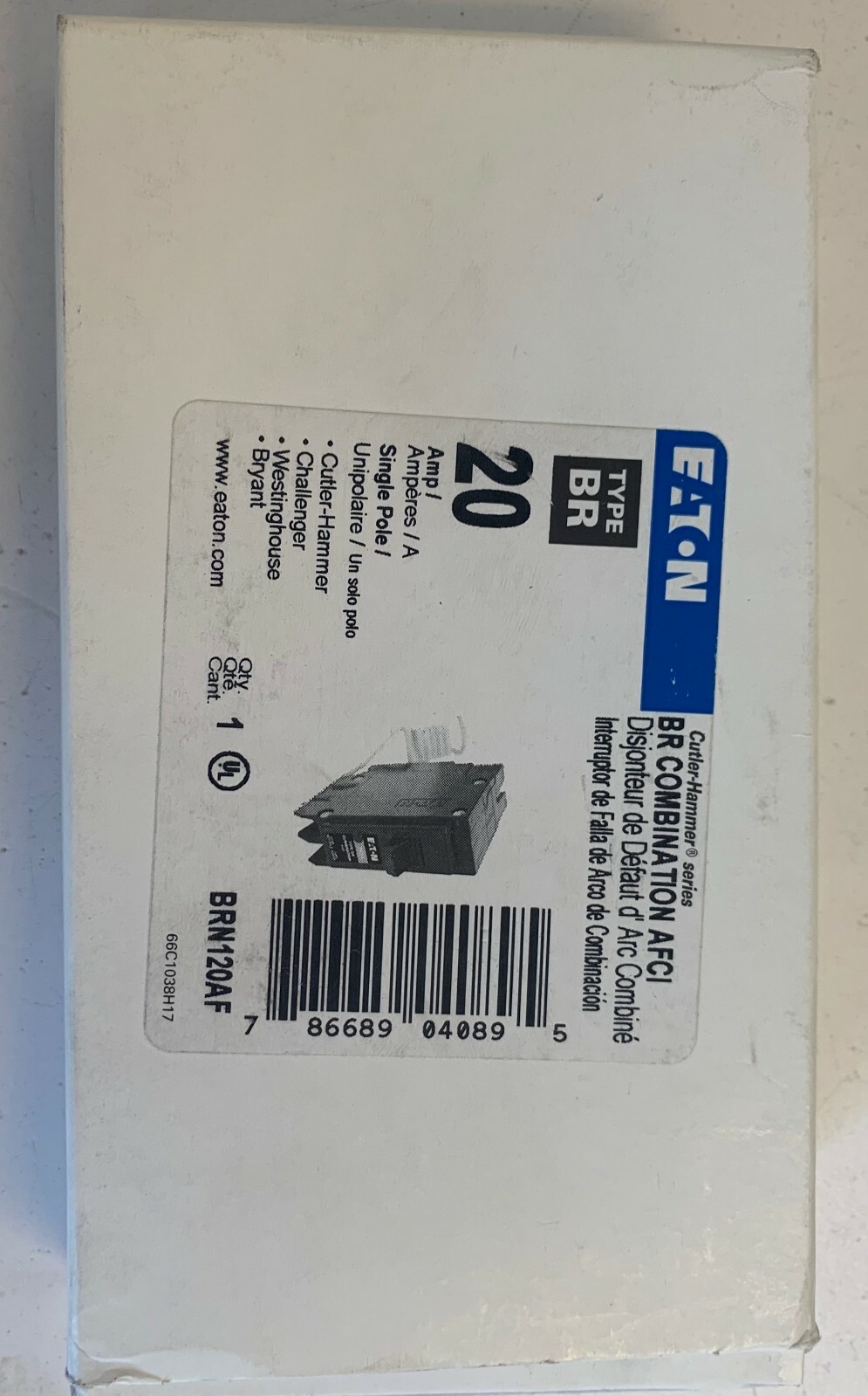

All my outlets are GFI protected with GFCI outlets. I did not GFI my overhead lights. Now I looking to power a reel-type drop light and was looking for a GFI breaker.
This one from HD is what I was expecting from a GFI. It is 49$
https://www.homedepot.com/p/Eaton-BR-20-Amp-Single-Pole-Self-Test-Ground-Fault-Circuit-Breaker-GFTCB120CS/206109781

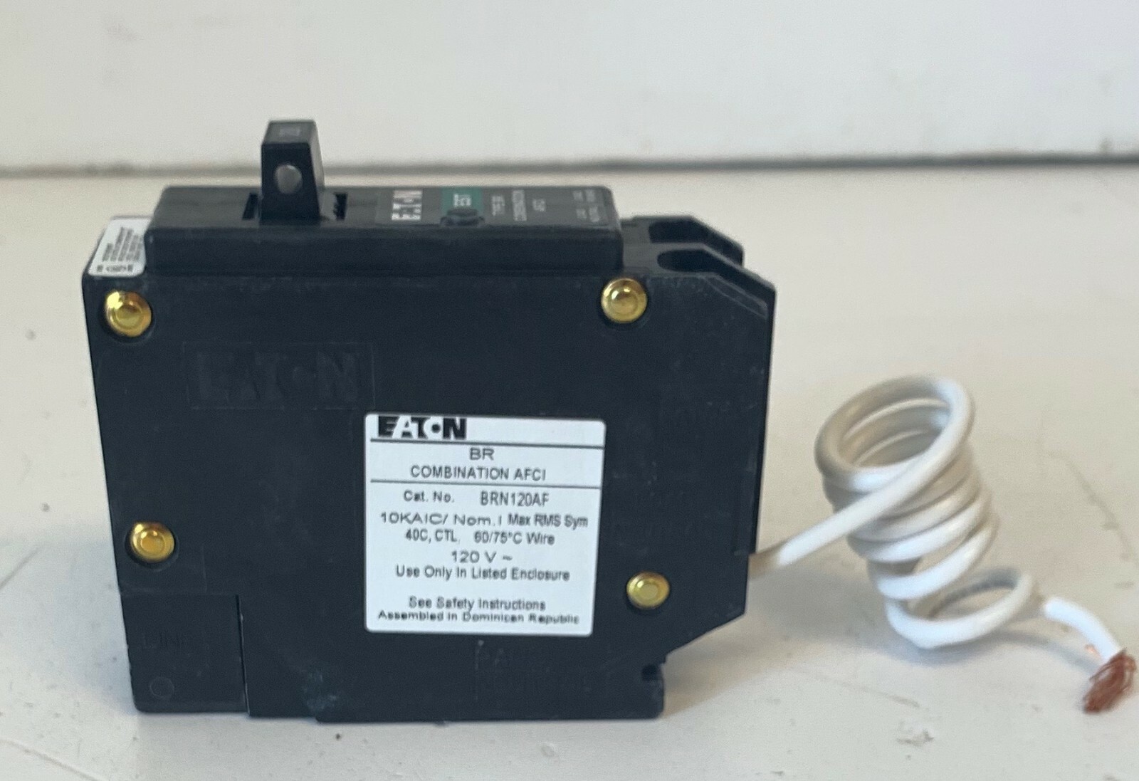

This one looks like it should work
https://www.ebay.com/itm/BRN120AF-/313279876159
Does the EBay one protect GFCI. I know it says arc, but it also says "combo". What does it mean by that?
Terry D
Mar 25, 2015
2,202
St. Louis, MO.
The one you have linked from Home Depot is correct. The one from EBAY is a combination arc fault. They are two different breakers
P
penright
Dec 27, 2016
618
SW of Mustang, OK
I thought something did not smell right.
That is NOT a GFCI. Its a combo AFCI- which detects parallel and series arcs.
Return it...
I had not bought it yet.

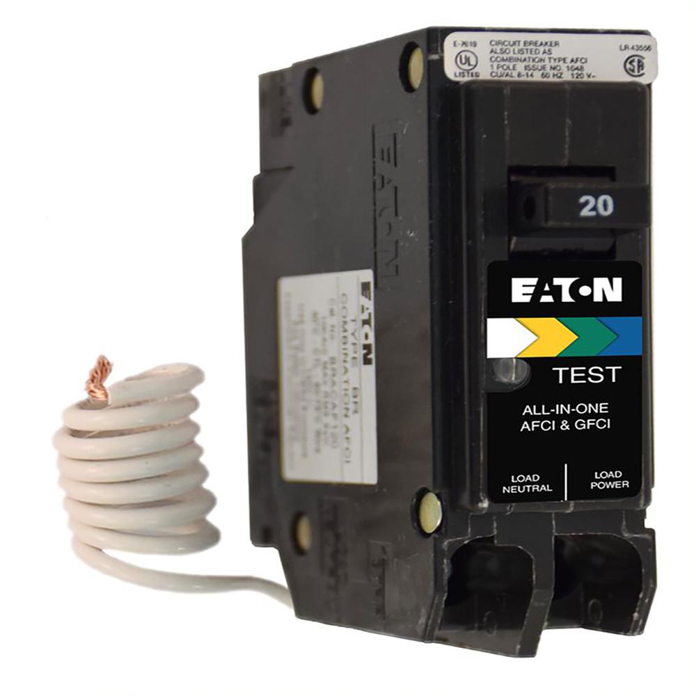

Can't say if the Ebay item is a combination GFCI/AFCI . THe labeling doesn't indicate anything other than"Combination".
Here is a link to the HD combination unit.
www.homedepot.com/p/Eaton-BR-20-Amp-All-in-One-AF-GF-Breaker-BRN120A1CS/311720450
I think that's the one I am going with. Any last thoughts before I buy it?
I was not going for arc protection, but it only a buck more. The main thing is the GFCI, I have seen them (GFCI) work. I know there is a lot of discussion around them, but for me, I am a believer.
On one hand the drop light it's self has a plastic handle, but it does have an outlet and someday something could be plugged into it, or maybe something drops and cuts a wire.
Thanks, everyone.

Plug on Neutral. What you have is a AFCI breaker with a pigtail. PON panels do away with this. There is a neutral bar that that runs up and down on both sides where the PON breaker attaches. The breakers are not compatible vise versa.
beelsr
May 6, 2007
1,324
NE PA, USA
plug on neutral. the neutral bar runs down the panel and you, umm, push the breakers onto the neutral screws that are still there, rather than wiring them with pigtails. makes a cleaner box with all the *-fault type breakers.

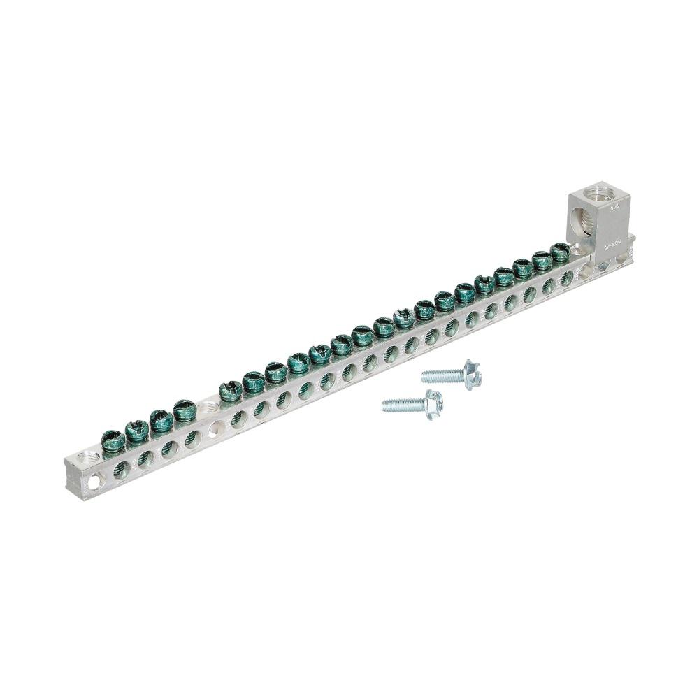

You actually need to buy a grounding bar and install it. Dont touch that large jumper that is highlighted in red. Both bars are isolated from the panel on plastic blocks. The bonding strap is what set it as a grounding bar. See my next remarks below.
The bonding ******** the left side (4 screws down ... the one that is secured to the panel. I circled it in yellow in attachment) needs to be removed. This gets missed alot. IF its a main panel you leave it. IF its a sub panel then you remove it and it isolates the neutral from ground. Then you add your grounding bar you need to buy separately. It will mount next to it with the screws holes tapped in the panel. There is one that is made for you panel. Its listed in the instructions. Should be stocked in HD or Lowes. Thats how you ground the sub panel.

If it was a main panel then you can combine the neutrals and grounds. This is a sub so they need to be isolated .. hence the reason you ran 4 wires.
So is this bar what the ground rod that was driven connects to?
Does not that strap connect the ground to the neutral? And the Grounds are tied to the boxes. Shouldn't both the ground and neutral only be tied at the main?
You will end up with 2 large neutral bars. One on each side. This allows you not to have to run all your white wires to one side. On older panels there would be one large bare like you have. All those GFCI and AFCI pig tails would have to make it to the other side. This lead to a mess of wires and if they were not long enough, then wirenuts and extensions to make it. There are holes in the back of the panel. Look up the model of the panel or in the instructions you got when the panel was taken out of the packaging. IT will list how to set this panel up.
https://www.homedepot.com/p/Eaton-2...V1tzICh2xmgfsEAQYASABEgKe5vD_BwE&gclsrc=aw.ds
This is most likely what you need to buy given its a Eaton BR panel. It will attached to the back of your panel. You will see 2 small raised dimples on the back of the panel pan and 2 holes above and below them. This is where it will mount. Its all in the instructions. All your ground attached to the large bar on the right will be moved to this. Only white wires will be attached to the 2 large bars on each side of your panel.

both existing bars are neutrals and you are to leave the tie bar and remove the silver bonding lug
then add 2 ground bars, one each side, and move ground wires and the GEC from the rods over to them.

https://www.homedepot.com/p/Eaton-21-Terminal-Ground-Bar-for-Type-CH-and-Type-BR-Panels-GBK2120/302610360

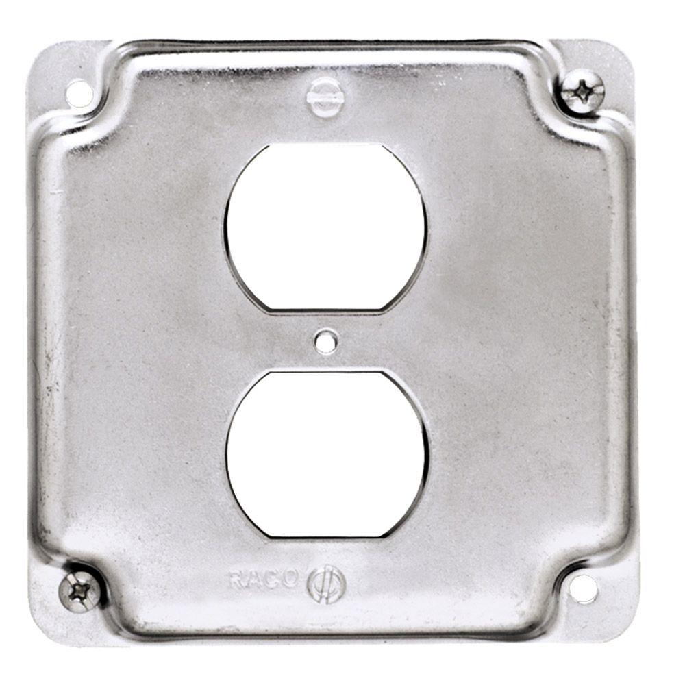

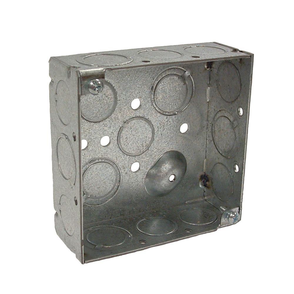

https://www.homedepot.com/p/RACO-4-in-Welded-Square-Electrical-Box-with-Raised-Ground-8189/100539828
https://www.homedepot.com/p/RACO-4-in-Square-Exposed-Work-Cover-for-Duplex-Receptacle-902C/100038014

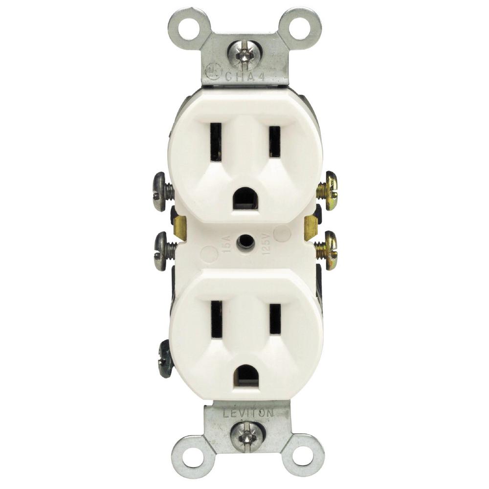

https://www.homedepot.com/p/Leviton-15-Amp-Residential-Grade-Grounding-Duplex-Outlet-White-R52-05320-00W/202066670

If you haven't actually hit the button yet, may I suggest this receptacle instead?
https://www.homedepot.com/p/Leviton...e-Duplex-Outlet-White-R62-CBR15-00W/202066707

The washers under the screw heads mean you don't have to curl the wires either, saves time when you're installing, and you can put two wires under a screw to maybe save a wire nut.
I did pull the trigger, but I can swap it out when I go to pick it up.
Never notice the difference before. There is a difference in construction.
I would be surprised if the code would allow you to use the same screw for more than one wire. Are you sure that is ok?

I don't think you need to buy a ground bar. You just need to remove the bonding strap near the bottom, and relocate the other bonding strap (circled in yellow below) to the other side, where your grounds are. The bar on the left will be your neutral bar and the one on the right will be the ground bar. That's how I installed my panel. I don't know how easy it will be to remove the bottom strap though. My panel has a similar strap and it's spot-welded to the panel. I left mine in place, since it only connects to one bar, which is my ground bar.
Under the manufacturer instructions the bonding jumper "circled yellow" is removed and a ground bar kit is installed. It is not the intent or suggestion of the manufacturer to modify the panel by removing the connection strap between the neutral bars. The manufacturer approved way is to add the ground bar kit.
I would assume so, although honestly I have not ever looked it up code wise. The side screws on those receptacles have a square captive washer under them; you're supposed to just shove the wire under the washer on one side of the screw head and tighten it down (no bending/curling.) These same kinds of terminals are used on fire alarm devices and on those two wires under a screw head is not only allowed but necessary as there is only one terminal each for + and -. See page 3 here
https://www.eaton.com/content/dam/e...ock-rss-strobe-wall-install-sheets-P83911.pdf
I like this better because if you then are installing the recep without wire nuts in the middle of a circuit, you can put both blacks and both whites under the same respective screws, and then the pass through current is going through only that washer and its corresponding brass piece that it's clamping down on, and not through the breakaway tab.
Another argument that this is intended for two wires under a screw is that with some of them - maybe even the ones sold at HD? - the square washers under the screw head are actually formed a little bit to hold the wire, and they are so formed on both sides of the screw head.
I was hoping that the installation instructions for the receptacle would clarify this, as the installation instructions have to be reviewed by UL as part of the listing, but they are pretty generic, at least for the Leviton ones I looked up (I was trying to show you something specific to the things you could buy at HD as that seems to be where you're shopping). I tried looking up Hubbell who has much better install sheets, but the ones I looked up those devices don't have the washers like I'm talking about, so you absolutely cannot do 2 wires under a screw there.
edit: Have a look at this Eaton receptacle here
https://www.lowes.com/pd/Eaton-White-15-Amp-Duplex-Outlet-Commercial-10-Pack-Outlet/1001438142
this is a slightly different design where the screw draws a square clamp against the brass contact area. But as you can see there are eight holes in the back of the body, allowing for two stripped wires per screw head.
the bar at the bottom with the black rubber is NOT a bonding strap. it is a tie strap to tie the 2 neutral bars together.
the bonding strap or lug is the one you circled in yellow.
the manufacturer wants you to add one or more ground bars and remove the bonding strap. leave the tie bar.
what you did in your panel was most likely incorrect but i would need to read the info from the manufacturer.
