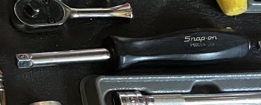

Edit: One of my favorite Snap On tools is my F50CSA. They don't make this anymore. Its basically an extension with a screwdriver handle on it.
I probably paid an obscene amount for this 30yrs ago. I use it almost every time I work on anything. Was probably $30 when it was new. Was it worth it? It was to me.
