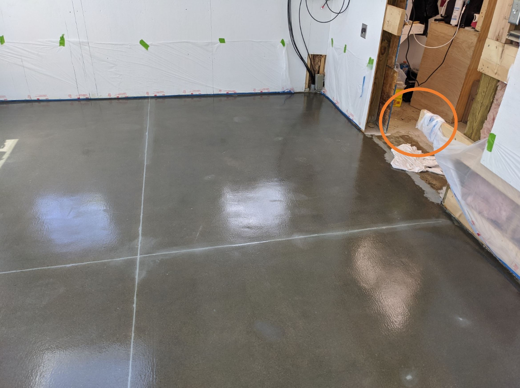

I ordered and installed the Armorpoxy ArmorUltra with "Military Grade Top Coat." However, I made a mistake because I ordered "Clear." As you can tell in the picture below, this is pretty dark. Certainly darker than my existing shop floor, circled in the picture. I'm not looking for perfection here. However, I'm getting older and my eyes aren't what they used to be. Consequently, I'd really like a lighter color.
I'm thinking about lightly sanding the floor, ordering and applying another layer of the top coat with a color added. For example, Desert Tan. However, the top coat goes on pretty thin and I'm not sure if this would work. Any idea?

I used armorpoxy and love it. I did 3 coats: first was a 2 part epoxy primer. Second day was the 2 part color coat with chips on top of it. 3rd day was the military 2 part epoxy clear coat with anti-slip powder in it. I would call armorpoxy and ask what to do. My guess is a light grey or tan color coat followed by the clear coat again.

I think your floor looks great!!!! But everyone has their own idea. I'm not sure you can add color to a urethane topcoat layer as normally the color is in the epoxy coat.
With the polyurea products however you can add color. You might talk to one of the single part polyurea folks (eg. allgaragefloors and I think armorpoxy has a single part polyurea as well and see if applying that over a urethane top coat is feasible. You would be doing two coats first with polyurea with a color additive and a second clear coat.
Otherwise I think you are down to grinding the entire floor out and starting over. That said I think your floor looks gorgeous as is.
For what it is worth, I did an Armorpoxy ultra with light grey about 3 years ago. And was unsatisfied with the yellowing that occurred. It wasn't necessarily Armorpoxy, rather epoxy is UV sensitive. I've recently moved and this time around am going with the one part polyurea. The older polyaspartic and polyurea products were too difficult to apply as the working times were difficult, but these new one part products are pretty much ideal.. Long pot times, quick curing and not subject to inherent epoxy yellowing. (and yes it yellows around the edges even if you don't leave the garage door open)

I ordered and installed the Armorpoxy ArmorUltra with "Military Grade Top Coat." However, I made a mistake because I ordered "Clear." As you can tell in the picture below, this is pretty dark. Certainly darker than my existing shop floor, circled in the picture. As you can tell in the picture below, this is pretty dark. Certainly darker than my existing shop floor, circled in the picture
If you got it wet, it be about that same "darkness" - I also think it looks great.
It's going to be very difficult to match concrete that it unfinished - I don't think that's a reasonable expectation...
I'd hate to pull all that up also.. I'd be looking for something compatible in a solid color that you like to go over it.

Hi, with minimal prep you can apply a lighter color pigmented topcoat right over this. We can give you a courtesy discount since you aren't happy with the color.
