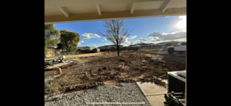

Broke ground - actually just started demo
Had a horse stables and a tack room to remove.

And just like that 200 cu yd’s of dirt are spread.
Retaining wall footers are dug and my dogs are loving the dirt. We still need another 120 yds of dirt to level the grade. Hoping that comes tomorrow.
Funny how timing works. Had to leave the house for work by 1pm. No trucks. 1:15, phone rings, “Where ya want the dirt?” 🤣
If we can sort out the water/waste thing then definitely will use a point-of-use heater. We have an on demand one for the whole house. Couldn’t be happier with its performance.
The garage door openers will be the side mounts with the dead bolts like @Boostingaz has. Great piece of mind.

Had to go to work for the last 10 days.
A little bit got done while I was away.
Another 300 yards of dirt, the block retaining wall guys are hard at work, even today. They should be done by Monday with the stacking and filling. They should finish the sealing and painting by Friday.
Next is spreading the fill and making sure we have enough.
Permits show on track for the 28th for approval.

That drain looks nice. Should work good. Get a decent slope into it so it's less "labor" squeegeeing everything into it for cleanup. Will they let you drain gray water just on the ground? Or do you still need certain provisions for dumping?
