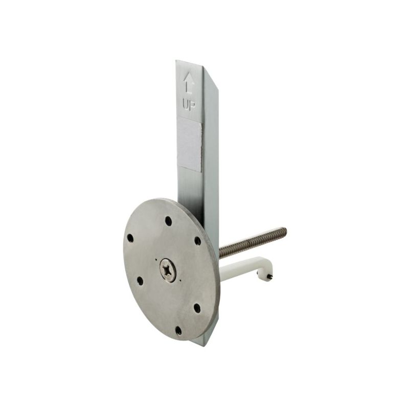

I just did some remodel work in my bathroom and decided to add some grab-handles while I was at it. I was pleasantly surprised to find that all sorts of visually appealing options now exist, often tied to other elements like towel bars or even faucets. So, form and finishes are really broad.
Anyway, all of the bars I bought came with interesting drywall anchors that have HUGE grab areas (See below). I was able to add blocking where I needed it since I had the walls open, but the bar manufacturers all felt these drywall anchors would be adequate. If you do a Google search for grab-bar drywall anchor you'll find a ton of info. Way more people need these bars than can manage to add blocking or always hit studs...

not directly on sheetrock. You will need a backing and front mount plate surface sandwiched to hold it IMO.
e36jon
May 2, 2013
237
San Francisco CA
Greetings BadgeZ28
I really do hear ya. only sheet rock seems improbable. They do ask to have one end stud mounted.
Here's a link to the directions from Delta (Others are similar): https://media.deltafaucet.com/MandI/102831%20Rev%20C.pdf
The text for the anchor install reads:
WALL ANCHOR MOUNTING DIRECTIONS
DO NOT install supplied wall anchors into wallboard less than
½” or greater than 2 ½” thick.
DO NOT install supplied wall anchors into wallboard that has
been subjected to water damage or decay.
DO NOT install supplied wall anchors into a wood stud.
NOTE: Opposing end will need to be mounted using the Stud
Mounting Directions in Section 1, steps 7-9. It is suggested to
locate and mark opposing stud end.
