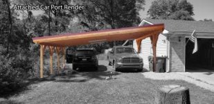

My main garage has a 4 post lift, which occupies all of my space and the hail we get is something brutal. So now I'm in the process of regrading the land and adding a door to the side of my garage which will hopefully someday here soon become an attached car port
Attached is design I like as it looks simple and economical for my use
Also attached are the basic dimensions needed to comfortably fit everything in, but I'm wondering what's the best way to design this while keeping my costs low
Third picture is an overlay
Any ideas?

Man i would just carry your existing gable all the way over. It will look much better than angled car port.

The idea here is to keep the costs as low as possible while adding some protection for the vehicles, I'm putting crushed rock down and am under the assumption that long spans of board are cheaper than trusses?
This, I doubt you have enough height to do what you want. At 2/12 slope you end up with 56" on the low end, and that does not include any joist depth to carry the snow load built up at the existing garage gable.
Being in Indiana, a flat roof will need swept off periodically in the winter.

So you guys are recommending something like this? Judging by the photo I attached originally I didn't think slope would be an issue (assuming the door in the photo was 80" tall and the height I had to work with is around 100" which appears to be similar)
What would be the best method for designing this to keep costs down? gable end trusses and 2x6 perlins running across to each with joist hangars?
I got around 128" in the pic to the roof deck, and no way it is 28' long. 6" landing, 82" door RO, 8" vert brick and 8 courses of 4" brick. (It could be 8" less if they used shorter bricks)
You can go shallower in slope, but I would not in snow country. Some manufacturers will allow SS metal roofs down to 1/4" per foot, but usually caution against areas with snow.
Cheapest structure would be to build it like a pole building, attach one side to the existing structure. Downside with running the ridges parrallel will be the header(s) you need on the drive in side

Am I correct in assuming that you are considering a low cost carport over a four post lift, and want to have standing room under the lifted vehicle?
The carport in the drawing, IMHO, looks short on headroom.

With your existing roof line the way it is, don't even bother making it attached as your headroom on the left side will be way too low to accommodate the slope you need.
Two options I see- either do a freestanding mono pitch with the pitch going front to back or simply extend your existing roof line as mentioned earler.
Truss prices from Menards looks to be about $120 per truss.
https://midwest.menards.com/TrussOnlineFob/index.do#/landing/Truss/true

If you decide to extend your existing roofline, the link below has some pictures and a good discussion about wind load design and construction considerations.
https://www.garagejournal.com/forum/showthread.php?t=180041
You mentioned you want to keep costs down, but you might want to consider designing the carport so that in the future it can be easily converted into an enclosed garage. That would give you or future owners of the house the option to convert the existing garage into additional living space -- a master bedroom and bath, a rec room or some other use.
Another thought if you extend the existing roofline -- it might be cheaper to construct the carport with footings and walls on the side and back rather than the beefy columns, headers and roof structure that would be required for an open carport.
