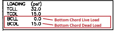

I'm one of the guys here who always says "Don't store anything on the truss lower chord unless the trusses are rated for it."
My response to the OP in this thread is, it is new construction, get a copy of the plans and see what the truss lower chord is designed for, and proceed based on that information. It's not a mystery at all, due dilligence will answer your question.
The trusses are designed for combined loading conditions such as environmental loads (wind, rain, snow, etc.) If you stack weight on the lower chord in excess of it's design capacity you may never know it's an issue until there is, for example, a snow storm that is accompanied by high winds.. that's when you'll find if it's an issue. Not on the nice sunny calm day when you load the stuff into the attic.

The pictures below outline what to look for on the truss drawings...
A bottom chord dead load of 5 psf is what is typical for a ceiling and insulation... the truss shown below has 15 psf which is good for light storage.

I am still waiting to hear back from the builder although I did a little digging on my end. I believe its a 5/12 roof. Also its the same for 20'/22'. I attached a picture from the good ol' Menards website it appears they design everything to 62 lb per sq/ft. Appears they do not have a life load but the Dead load for btm cord is 10..
Thoughts? (I am not saying these are my trusses Although image looks close and stats look close)
