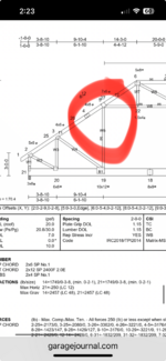

I just built a 4 foot, 8/12 truss on Menards website with a 36 inch energy heel and a 20x8 attic space. $479 each..
Circled region is where insulation gets pinched. We typically infill this region with a sloped member to get insulation depth and clearance for baffle vent.
Does the Menard’s site allow you to create that truss profile drawing?
I saw that. The 3d rendering had a bigger 'heel' there. I would talk with the truss designer over the chat function and see if they can either slope the room corner or raise the heel at the wall connection another foot. Or use exterior rigid foam over the sheathing. Or just build my own drop ceiling. I've always found them very accommodating when asked about specific designs. Especially if they have a base quote to start from.

Do you have your truss supplier do that or is it done in the field?
We field frame the clipped ceiling for insulation depth. Our truss vendor won't do that.
Also, with an attic truss, you typically will need to string line the uprights as they usually are not in a straight line and you will need to scab them so your vertical walls are straight. Then you add Thermo-ply or similar air barrier on the back side of the vertical walls to stop convective currents on the back side of the insulation. Sorry, no pictures of this. Extremely important to not omit this.
Lastly, you need to block the attic floor bays solid (so wind from soffit vents can't blow insulation thru yielding a cold floor). You also need solid blocking at the attic base board level. This picture shows how we blocked the attic truss bays solid and then applied spray foam to the bay blocking and the base board level blocking. Later after drywall, the dead attic space gets overblown to R43. Ignore the the sound bat rock wool the customer wanted. This detail is very important to getting a good seal at the attic.
