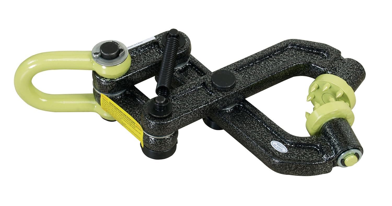

I saw this on YouTube the other day. Connected to a good sized tractor, it can dig in and easily pull out stumps up to several inches, roots and all.
Anyone ever seen one of these before ?

Now I have a BrushGrubber.

I looked at them but it doesn't look to me like the jaws come together well enough to pull something with a 3/4" diameter or so. I should've thrown something in for scale so you could see how small the trunks are that I have to grab a hold of.
