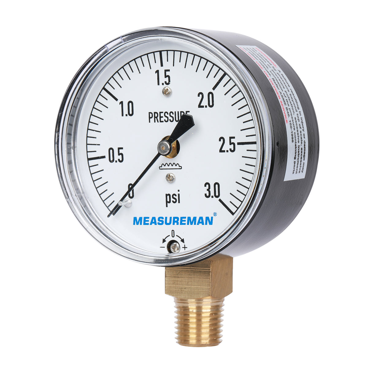

I recently got a Honda ATV, and I'm looking for a good quality low pressure tire pressure gauge. I need accurate readings from 1.8 psi (12 kPa) to 2.6 psi (18 kPa). All my tire pressure gauges go to 60 psi or more, so I have zero confidence trying to get an accurate reading at the bottom end of the pressure scale.
Do any GJ members have a good recommendation for a quality low pressure tire pressure gauge?

I have a inflator that uses a standard bottom mount pressure gauge. Replace the gauge with a decent quality 10 PSI or 5 PSI gauge

No reason for it to cost a fortune. I'd suggest the Tusk low pressure dial pressure gauge.
It is accurate, inexpensive and should provide enough resolution for your application. I used one during my dirt bike racing days and found it very reliable (usually I was adjusting between 7.5 and 13.5 psi depending on the terrain and conditions, but I don't see why it wouldn't work at a lower range). It has markings every 1/2 psi and it's easy to target something between them too (button on the stem to release a little pressure).
If you want something with an even lower range, there are more options. This might be a time to look at a motorcycle/atv specific website instead of general use tools. e.g. Rocky Mountain ATV/MC.

Thanks everybody for the ideas. I ended up going with this gauge, (thanks BrandonV):
I'll attach it to a tire chuck, and it should work out well. I've never aired down below 18-20psi when 4-wheelin', so 1.8-2.6 psi is a whole new world!
