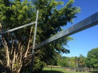

Well it is the Easter weekend, the rain has finally stopped, heat seems to be less, so I got some welding done yesterday.
Still waiting on the overhead beams, but started filling in bracing. Yes this is what the engineer specified. 200mm x 100mm x 5mm RHS bracing. Seems we get a few cyclones here, and he wanted it to be strong! Will finish off the welds today, and add some more around the back. I am just having difficulty moving the 8m beam to the slab from where it is laying. Guess I'll have make some friends.
Before anyone says anything, yes the first beam is welded across the top, and back side. Just tacked on the easy side.
Cheers,
Ken

Some serious steel! just curious how deep the piers are and how the uprights are attached to the slab?

Hey joeyp,
There are no piers. Just a slab with a 450mm wide, and 300mm deep edge. Lots of rebar. The uprights are welded onto 10mm gal plates with tangs extending into the slab. Not going anywhere!
