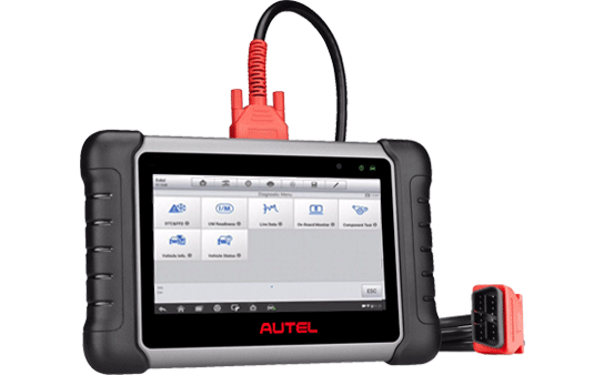

I was thinking of the MaxiPro MP808.
Found a good price here. Is this website legit?
Says it basically does everything an MS906 does. I need good data releans, resets, bidirectional controls. I don't need TPMS, or ecu coding. Was also looking at the DS808. Anyone used either of these?
