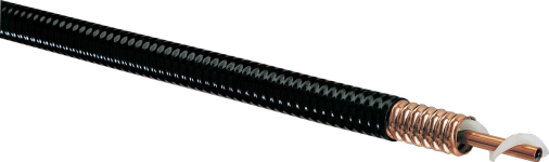

You are mostly right. The higher the frequency, the more it travels through the outer skins. Some cables are not cables at all. Look at a cell tower. Those cables are corrugated copper tubes coated in vinyl. They are not even smooth. The walls are crinkled so the current leaves the conductor and skips along the ridges with less resistance yet. One of the reasons that a stranded conductor has less reactance.
dave*99
May 5, 2009
4,361
Coastal NJ
The walls of those cables (often Heliax manufactured by Andrew) are corrugated to provide flexibility. The alternative construction is hardline microwave cable. Hardline (smooth tube jacketed coax) has slightly lower losses than Heliax, but has poor or no flexibility especially in larger diameters. You can look up the loss tables for coaxial lines of different construction types. Hardline and Heliax provide significantly lower loss than flexible coaxial cable.
Current does not skip along ridges.
Heliax cable:
