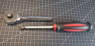

Warning: Ratchet-***** rant follows
backdrag has no apparent relationship with tooth count.
This isn't true. There's a high correlation between backdrag and high tooth count. If you actually look into it you'll find it can be overcome with good design of the mechanism. It's why you see so many iterations from the mainstream pawl design like Bahco/Snap On's Dual 80 and the staggered dual-pawl design of the 120XP that are trying to increase the effective engagement of teeth via pawl design vs. strictly running more teeth. Then there's Facom's design (I call it a 'wheel-pawl', but that's literally just me). Here's what I've seen over the years:
Standard (via Tekton)
Dual 80 (from the SnapOn site)
Staggered Pawl 120XP (from ToolGuyD)
Facom (I believe this is a screenshot from the CatusMaximus vlog)
I'm not even sure what this one is called, but it's generally found in low-tooth-count ratchets, often cheap ones.
There are probably others and/or variations on a theme. But at the end of the day, tooth count is one of the key things that drives backdrag. All that engagement has to "let go" when it's not working and has to feel right/be smooth.
To me it seems like things cap out around 90 physical teeth. Beyond that I'm guessing you're losing strength in ways that are probably difficult and/or expensive to solve. In general, tooth and pawl design - size, finishing, etc. and even factory lubrication have a lot to do with how well the ratchet perform in general, and particularly backdrag. Size matters too - some of the worst backdrag I've seen has been on 1/4" ratchets, especially ones with a high tooth count. I'm not so sure that mass of the head itself doesn't contribute to backdrag reduction. As you increase the number of teeth, dialing backdrag out of the experience gets harder. Some manufacturers are more concerned about winning the marketing war than having a great tool. Some do the work. Price isn't the best indicator, but in general pro-targeted tools unsurprisingly tend to be the best.
Personally, I don't like the 120XP mechanism at all - it feels..."thin" to me and sometimes has crazy backdrag and sometimes not depending on what ratchet you pick up. I'm guessing that has something to do with factory lubrication and possibly the interaction of th two stacked pawls, but whatever - not a fan and any that I've ever held/tried. I haven't had a situation where I needed more than the 4° - 5° or so provided by the various ratchets I have, which are all somewhere between 72 and 90 teeth. I've tried out a couple 100-tooth ratchets and found them riddled with back-drag and they were returned. If there's a 'good' one out there at 100 teeth, I haven't held it. For me, Snap On's (via Bahco apparently) Dual-80 does have the best feel, but my Icon 90-tooth ratchets that have a very standard design are pretty close behind. My Matco Eighty8 and SK LP90 are a step or so away fighting for third (originally I didn't like the LP90 very much at all, but it has seemed to 'break-in' and is pretty nice. Sample variation plays here too - I think it's at least partially a lubrication thing, but there's even some between my SnapOn ratchets.
But I'm pretty sure tooth-count is the primary factor in back-drag. It's just that most of the ways to address it are in most modern designs.

Actually the formula for friction is coefficient of friction of the mating materials times the force. Area is irrelevant. Therefore, number of teeth is truly unrelated to back drag. This is one of the most misunderstood standards of engineering.

That's interesting, but if the number of teeth were low for example, wouldn't the angle of the gears have something to do with backdrag?
That's true in ideal conditions. But there can be sticky grease in a ratchet, and that can make a notable difference. Sticky grease bonds like glue would, and the larger the surface the stronger the bond.
It's similar with car tires. Theoretically it shouldn't matter if you have fat or narrow tires. But in practice, friction is not the only force between the tarmac and the rubber. Basically, especially with hot rubber, there are actual chemical bonds formed between the asphalt and the rubber (it gets glued to the asphalt), and those actually do depend on the surface area.
Ideal friction is better observed on e.g. a brake disc (uniform rigid surfaces...).
I didn't use the word friction, and wasn't really trying to imply it (e.g. my thought that smaller 1/4" ratchets seem to struggle more with it in my limited experience). What I'm trying to say is that high tooth-count seems to complicate the user experience generated by the mechanism. One of those complications appears to be backdrag. Finishing and factory lubrication also seem to contribute.
I'm not an engineer, so I won't try to argue the standards with you. I'd only say that I don't think it's a simple discussion of the relevancy or contribution of friction.
I'd love to ask the team at Snap On why their 1/4" Dual-80 mechanism has 72 teeth vs. 80 on the 3/8" and 1/2" mechanisms. There's a decent chance that what I'm talking about is reflected in their answer...
In addition to the above, the pawls much be displaced when the thing reverses. As you move the pawl further the return spring compresses more than the force applied by the spring goes up.
However, I think the bigger differences come from the fundamental design type rather than number of teeth. Within a single design type I would expect more teeth to have less drag if everything else was equal. I wouldn't apply that across designs.
I doubt backdrag played into it. Instead it was probably a concern over mfg tolerances and minimum tooth depth of engagement. Consider that if I have a pair of gears and my mfg process results in a 0.010" +- tolerance between the centers of those gears. That means the gears might be as much as 0.01" closer or further apart than my design intent. If my gears are 4" in diameter maybe that isn't a big deal. If I reduce the gears to 1", that may be a big deal. Snapon may be hitting a mfg tolerance limit where the teeth on the pawl and anvil can reliably work with 80T on a part sized for a 3/8" ratchet but not when the parts are scaled down to 1/4". Conversely, the design might support more than 80T on the 1/2 ratchet but, perhaps for marketing reasons or just to keep things consistent, they stuck with 80 on the larger sized ratchets.

Great discussion on ratchet designs, guys! And M635 - your thoughts and internal pictures are awesome!
I have a pair of old (1930's) Herbrand pearhead ratchets that are extremely low backdrag - yet are very coarse toothed. Can't figure it out. And I've had modern ratchets like the above pictured standard Tekton that seem rough even with alot of teeth - and like to break the pawl at the thin midsection. Can't nail that down, either.
I think that ratchet designers lose sleep and pull their hair out wrestling with demands from the workplace. Low backdrag - but not too low. Lots of teeth for tight areas, but with sufficient strength to get the job done. Thin ratchet heads but able to take a 3 foot cheater bar. Durable enough for long life but not indestructible - gotta have them repeat sales. And affordable for the average Joe to buy - but keep that profit up!
I'm just glad I get to use the tools and not have to make them. :LOL:
That mechanism looks similar to the swing pawl Proto (and now generic) design. The switch operates differently and it appears to result in a "forward" vs "reversed" switch direction.
Yes, the usual formula for friction is F = μN.
AKA Amontons' Second Law: The force of friction is independent of the apparent area of contact.
They really shouldn't call this a law, it's really more of a "model".
In this study they show surface area does affect friction:
"The experiment results suggest that the friction force is roughly proportional to both the normal load and the real contact area during loading. Such linearity still holds between friction force and normal load during unloading, while fails for the relation between friction force and real contact area. These results illuminate that the linear assumption of friction force on contact area does not always hold."
In my experience designing my own ratchet, there are tons of variables, but it does seem that the tooth area in contact with the pawl is a factor. Explains why all my sub-3.0 in-oz ratchets are the tiny 3/8" drive in a 1/4" body ones. All the surface areas in contact with each other are smaller.
I was able to get 0.5-0.7 in-oz of backdrag - video in post #21.
Imagine a toothless gear - a helluva lot less friction lol. It's kind of common sense if you think about it.
The slightly newer Herbrand's have the distinctive "button" selector. These earlier ones had the bigger lever-type switch. Which I prefer when I have greasy hands.

Low backdrag is what's most important to me when it comes to 1/4" drive ratchets or 3/8" drive ratchets that will be used on small fasteners or in tight areas. They need to have low backdrag because I often can't fit my other hand in there to help the ratchet along if the backdrag is too high.
Almost all of my 1/4" and 3/8" drive ratchets have been modified internally for lower than stock levels of backdrag. My 1/4" drive custom modified ratchets all sit between 2-2.5 inch ounces of backdrag. As long as 1/4" drive backdrag is 3.5 inch ounces or less, I'm happy.
My 3/8" drive custom modified ratchets all have 3.0-4.5 inch ounces of backdrag. As long as 3/8" drive backdrag is 6 inch ounces or less I'm happy.
For reference purposes-
A stock Snap-on ratchet screwdriver with no modifications has 1.5 inch ounces of backdrag. A stock Snap-on 3/8" drive dual 80 ratchet has about 8 inch ounces of backdrag when new and about 6 inch ounces once it's fully broken in.
How you modify internal to get lower backdrag
