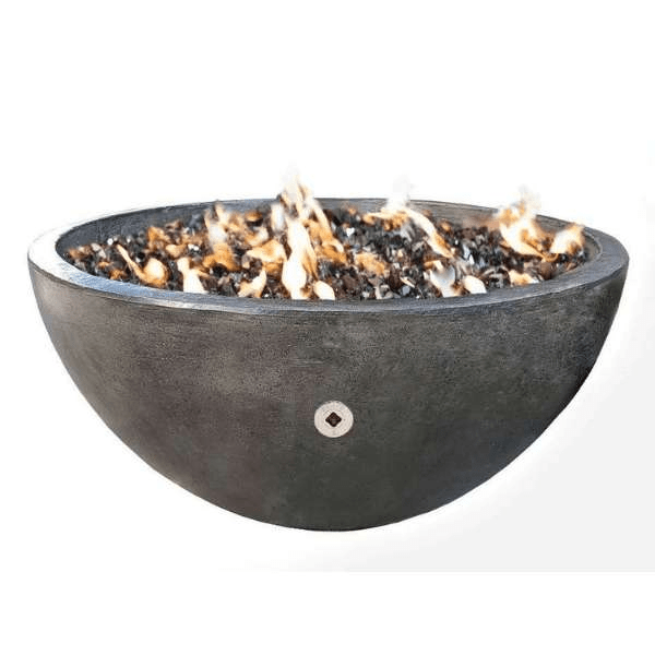

Sorry for reviving an old thread but Google brought me here. I'm also trying to conceal the propane line and thought putting the propane line that comes with the fire pit through pvc inside the slab out the side. The reg you point out is for indoors (a). Are you saying it also applies outside?
And assuming the concrete guy still creates a conduit in the slab, what is the general process (if any) to bring it up to code? Thanks!
It’s the low pressure side which is typically inside but not always. The reg quoted talks about both indoors and outdoors which makes a difference on allowable hose length. Keep a hose visible is required no matter inside or out.
The easiest way to make it code compliant is run a code compliant piping thru the conduit.
I would suggest using flared copper from the house and under the slab and attach it to a short post. Put a 1/4 turn shut off valve on the post or even a quick connect.
If you have the distance and btu input of the appliance I can size the line for you.

Thanks - here is the fire pit (147,500 BTU)
And just to confirm, there isn't a solution you recommend that still connects to just a 20lb propane tank?
There is nothing wrong with a 20lbs tank and a short hose.
Grills do it all the time. But they have short hoses and the hoses are not semi permanent installation that can’t visually be inspected before each use.
What is the resistance to running copper? It’s cheaper per foot, last decades without issue instead of having a rated life of 5 years. You can still use a grill tank with copper?

I'm just trying to visualize it with the goal of not seeing the line. And I don't have a way to run a line from the house. Imagine I'm way out in a field but still governed by city rules (no wood fire pit).
I'm trying to convert the picture above to be up to code.
So do I connect a short hose from the fire pit to the pvc/copper pipe, which runs from the center through the slab to the outside of the circle, then using a quick connect on the other end of the copper pipe, plug the propane tank into it, then hide the tank under the table? Is he just missing a copper pipe running through the pvc? Or what else is required? Thank you so much for your time BTW :)
