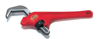

I would recommend a Hex or Monkey Wrench on plumbing. You can also use Channellock's if careful, but don't recommend after seeing all the beauty marks on chrome and brass fittings. Avoid Knipex unless you use the rubber boots.

Good to know about the hex pipe wrenches. I always wanted to know the proper tools for tightening toilet valves. Every plumber just uses channel locks and the teeth marks bother me a lot.
