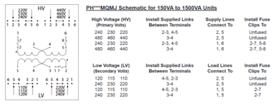

For the 110V lighted eye shields (weren't cheap), I want to add a current transformer to convert from 220V, otherwise I have to run 3 different cords to the grinder. Outlet is wired as shown, and the cables will be connected to a 250VA current transformer using 2A fuses (have this coming in the mail soon). I'm going to install the transformer in the empty space below, inside the motor's cradle.

3 phase machines are an excellent value as no one else wants them. The real total is $150 plus: $440 VFD, $270 lighted eye-shields, $140 miscellaneous electrical supplies, $280 grinding wheels, $60 for casters and angle iron for custom base, and $120 control transformer.
