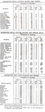

Most vertical bandsaws are designed for cutting wood and softer materials at something like 3000ft/min travel, including some aluminum. Just a quick google search of the model number you posted suggests that your bandsaw is one of these.
There were some Delta models that had a ~10:1 reduction gearbox and pulleys that allowed for the MUCH slower blade speeds for cutting steel. Attached are the guidelines for blade speeds and setups for some different materials for one of these machines.
Word of advice, if you DO plan on using this for both wood/plastics/flammables and also aluminum or metals I would clean out the former REALLY WELL before attempting to do the latter for fear of fire.

Thanks for the chart, that is going to be a real help.
Again, I know it was set up for wood. No question about that. I didn't realize quite how much I was going to have to slow it down. Oh well, it will give me a project to fool around with. I may end up with something that isn't ideal, but able to do the little bit I am likely to do.
