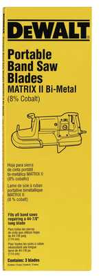

DEWALT Portable Band Saw Blade, 44-7/8-Inch, .020-Inch, 24 TPI, 3-Pack (DW3984)
this is the blade I have on that portable band saw,
should I get other type of blade to see better results?
Is your saw purpose built for metal cutting?
A wood cutting saw turns much faster than a metal saw.
yes, its bi metal
