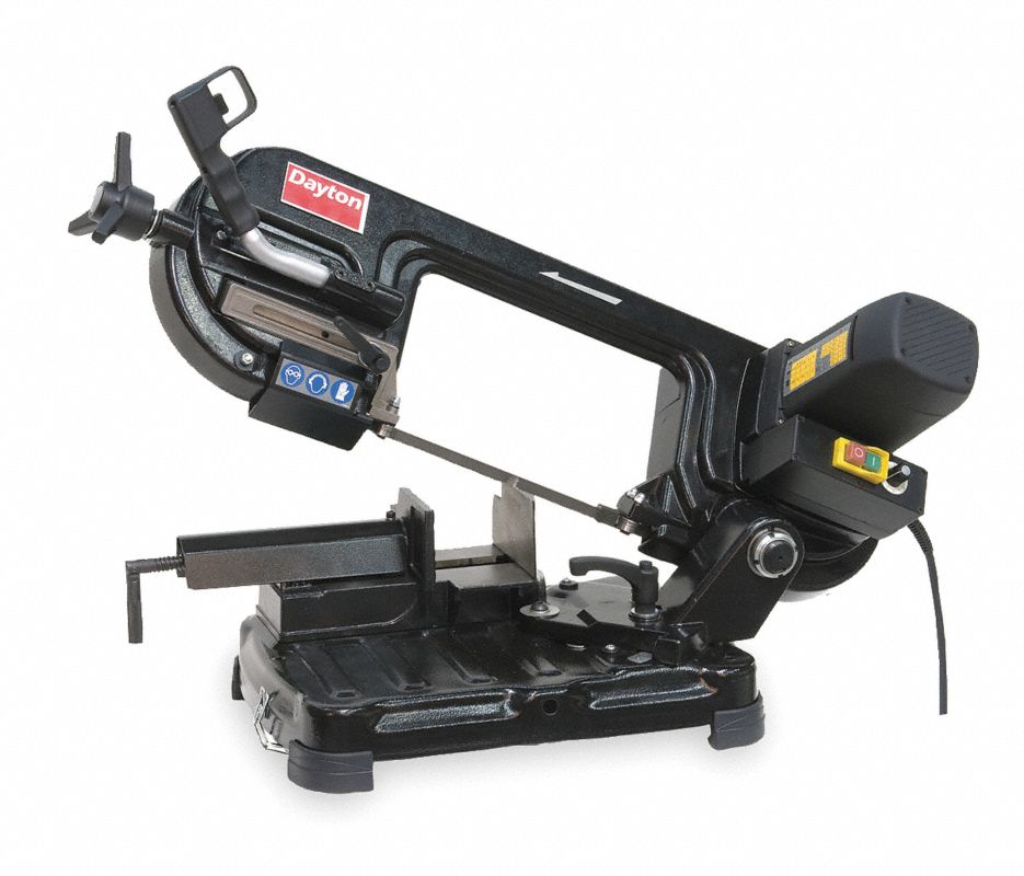

Grainger sells a Dayton branded one for a shade over 1000, Made in Taiwan...
And a smaller Dayton branded one for about 664...
