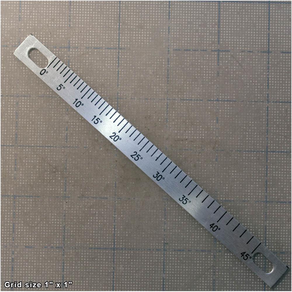

Hello, I recently purchased an older HF bandsaw and got it working pretty well. The one thing I wish it had, that is on later
versions, is the angle scale. HF says they don't carry them. It is #170 in the exploded view. Does anyone know where I can
get one? Or, does anyone have an HF saw that they could put a tape measure to the scale so I can replicate the angles on some
strip of metal?
Thanks!

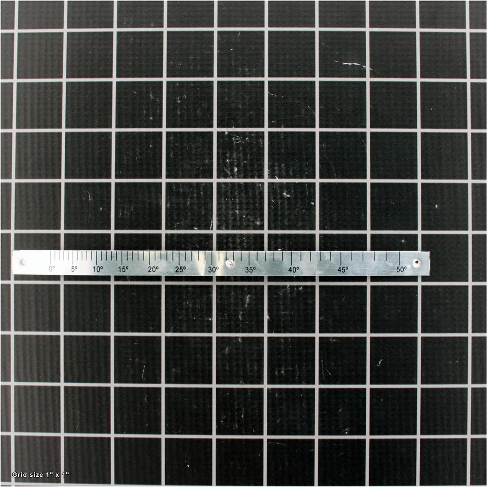

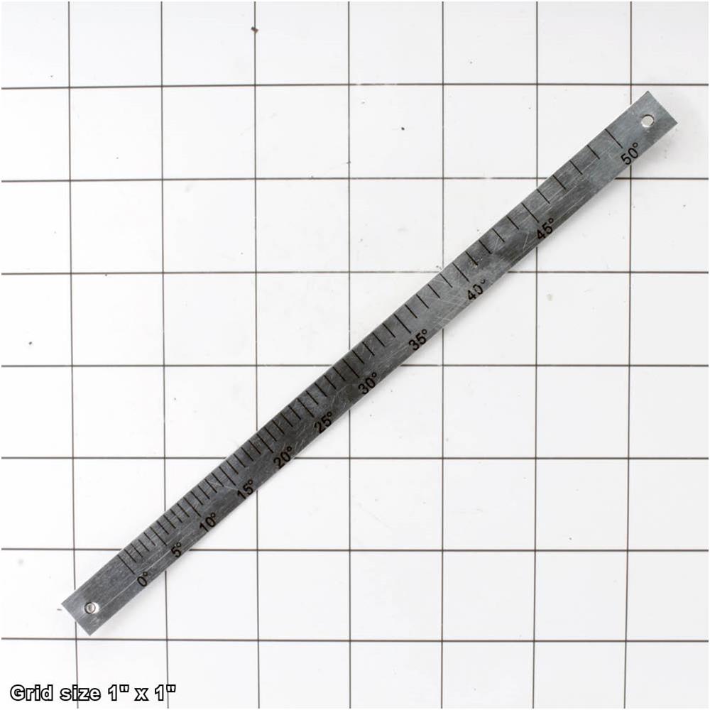

Judging by the parts lists diagram you posted, looks like the 4x6 bandsaw? If yes, it's just a RF-128 clone so you should be able to get one from any bandsaw based on that platform.
HF would have been the cheapest if they had it but Grizzly is probably the other easiest place to buy it.
From the old G0622:
From the old G1010:
From the current G0926:
From the current Shopfox W1715:

Yep, 4 x 6 band saw. The links are perfect. I'll give Grizzly a call on Monday.
Thanks! I like the block idea, too.
