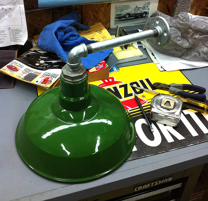

I am in search of some parts for a light (basically all I am using is the shade) that I want to rebuild and repurpose for an exterior barn light.
Does anyone know where I can find the same type of flange and light fixtures that barn lights uses. I have the shade and means to bend conduit I just need the flange and the actual light fixture.

I am really looking for something that a conduit can thread in from the top of the shade. As for the wall mounted side I am looking for something that will receive a threaded conduit. Just like the galvanized gooseneck that they sell at barn lights.

I also used a 1/2" plumbing flange on the outside of my buildings. I took a die grinder and took out the threads so the 1/2" pipe would slide through snug then attached the threaded end of the pipe to an electrical box on the inside of the building. The flange serves to hold the weight of the fixture and pipe without having the electrical box and threaded end supporting it all. Worked out good for me and is electrically correct. I have a total of four gooseneck lights on my buildings

Hack job? These lights were purchased as restorations from Barn Light Company and were supplied with the ends. The lights are from a paper mill and are from the 30's. The necks are 3/4" rigid conduit and the flanges are pipe fittings and look just fine.

Everything but the plumbing parts look good, the flange is hack.

I think correctly is the wrong word to use. Seems more like personal taste or opinion. There is nothing electrically wrong with these installations as long as they are weather proof.

Norcal may be right, strictly speaking. A friend of mine was gigged for using pvc water pipe for conduit - just for appearances, for low voltage, where conduit wasn't required at all! He had to put in the gray stuff and paint it.
So, could well be that if it isn't UL approved for electric, it isn't legal, and I'm fairly sure such a flange doesn't carry a dual listing.
It seems to me (just guessing here!) that if you used actual conduit and conduit fittings straight to an electric junction box, and the flange was drilled out for a slip fit over the conduit and only providing support, not in contact with the conductors, that might be permissible. I expect Norcal will chime in - he's certainly more knowlegeable than I am.

And it looks sensational! One thing I'd do to maintain those looks is seal those outdoor flanges where the conduit goes through, front and rear. I think the best choice would be Super Gray permatex silicone. I've used it for sealing conduit, and it blends in almost perfectly. Stops those pesky rust stains.
