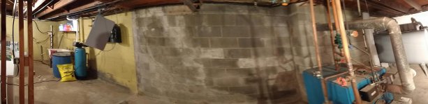

Hi,
The basement walls of my ranch home need some attention and I need some advice. The home was built in 1955 on a rock knob, I believe they had to blast rock to make room for the basement. Water never comes through the walls in rain storms but the basement is always humid in the summer time and the dehumidifier runs constantly (~1400sf. basement). The surface of the walls is very crumbly at some spots. What do you guys recommend? I have fixed some downspout issues, but the basement still stays very humid in the summer.
Now that my oil tanks were basically empty, I was able to move them out of the corner. I'd like to fix the area around them before I have to get them filled, then continue on finishing the rest of the walls.
I was thinking of parging the walls with cement then painting with Dryloc. I'd like to make it a finished basement at some point.
Thoughts?
In the attached pictures you can see the build up of dust on the floor from over the many years.

Is the dampness caused by condensation? In other words, is warm, moist air getting in and condensing on the floor etc?
I've got a similar situation and I am going to start by trying to seal, as best as I can, all air leaks around the old storm door, old windows, foundation sill etc etc. Solving the problem rather than trying to mask the issue (painting the walls)
For sealing, I'd clean well, (wet scrub brush, concrete cleaner) let dry for a good week or two, then drylock, 2 good coats -no skimping. I'd say, parge the worst areas, but no need to do the whole thing.

Tape some plastic to the wall, wait 48 hours. If there is moisture under the plastic the water is coming from the outside and drylock type paint will not help, indeed will just
be pushed off over time. Do this on the floor also.
yeldogt
Jan 2, 2012
18,184
In 1955 they were placing tar on the outside of the foundations -- if you dig down (outside) do you see it? They normally did not place a VB under the slab.
Using a large plastic square is a good way to see where moisture is coming from -- do you have any HVAC going into that area?
What type of dehumidifier ? The small home units with the included tank - are not up to the task. I have a Santa FE in one of my basements -- not cheap .. but will dry out a space and keep it dry for much less in operating costs. The small ones just run and run.
Products are available to slow the water transfer through the block -- anything you place on the block like paint will flake off .. even dry lock has a limit.
Your walls don't look bad at all -- the early block was not full cement.

After removing the plastic squares from the walls and floor, I did not notice any moisture on the block or floor. I believe this concludes that the moisture is coming from opening the garage door and not from water coming through the walls.

Here is the end result for now. Before and after.
I used an angle grinder with a wire wheel on it to prepare the walls and remove all the loose material, swept up all the dust, then painted two heavy coats of Drylok. The oil tanks also go two coats of Rustoleum oil based enamel paint.
I hope it holds up for a good long while.

Any chance there's pavement outside of the wall in the second set of pictures? The crumbling face is pretty consistent with chlorides eating away at the surfaces. occasionally, we see similar degradation from acid soils, as well.
I know it's too late, but I wouldn't advise on using anymore Drylock, until you give this area a few years (at least) to see how it does. Typically, all the drylock does is delay the inevitable, and come off in large chunks with the block when it fails.
