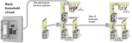

Ill get a drawing. Im wanting to run shop lights off one switch and a bathroom light off a separate switch all on the same curcuit. I can configure however the runs need be because will be
Rewiring feeding from attic space of shop.

I greatly appreciate the time guys. Rather than go from junction to each light i planned on basically junctioning at each light and daisy chaining over to next. Wouldnt that save wire also? I understand the how to wiring concepts. My first switch is like 40ft from the bathroom switch. I would have to run the extra 14/2 from first switch 40ft jyst for 1 switch and 1 light? I "thought" i could come off the nearest shop light to bathroom and junction from there for switch? This wont work? Sorry if annoying lol. Hooe makes sense what asking. If not ill draw my proroposal later. Thanks a million guys.

That will work as long as the wire in that shop light is always hot, if the wire in that light is being controlled by the switch then it will not work the way you want. Here is another diagram that might help.

Is there a code for amount of wires you can tap off of a constant for power? Im assuming as long as you dont exceed the fill space in j box or wire nut or exceed the circuits amperage its o.k.?

I believe your statement is correct. You'll do fine with your wiring, I wasn't born with any knowledge and like you have learned by reading, watching and asking questions.
