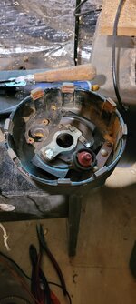

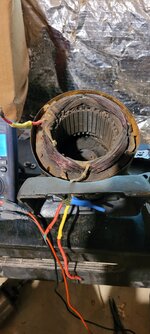

At the moment I've got this motor I'm going to try and rewire with the schematics I was given, any advice would be appreciated, from how to determine what's the start winding and the run winding, main winding and auxiliary winding, as I need to replace all the cracking cloth wire.

I have no idea how old this Sears and roebuck motor is this motor came with Craftsman my metal lathe and originally I didn't trust this motor because of the decaying cloth wiring, but that other motor went out and I don't have the money to buy another one so I decided you know what I'll take a crack at this20240804_170709.jpg

Is there a capacitor in that model?
As far as I'm aware there was no capacitor

This post may help, but includes an inline capacitor.
I still have that Companion wiring assembly and could try to identify the stator wire colors.
Regarding the start winding versus the run winding... generally the wire gauge of start winding is thinner than the run winding.

Yeah if you don't mind that would be very helpful

I believe I've made some progress.
I'm still don't fully understand the wiring schematics here
