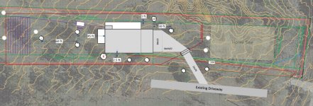

Despite half the world stopping around us, I got my development permit last week, and next week we break ground on our long-planned 40x60 metal building.
Framing-wise, it's actually 40x80, but 20' is open carport, and we're adding on a 12x60 lean-to on one side to contain a bathroom and utility room and shelter for a RV or toy hauler in the future. Since the county has a minimum septic tank size we might-as-well'ed ourselves into having a shower and an RV dump.
A sink in the corner of the shop could allow for building a small kitchen if we end up spending some nights there.
To that end, and to provide a nice spot for drinking a cold one at the end of a day I'm including a porch on the west end.
Planning on a 2-post lift pretty much dead center for most work, and allowing for a couple 4-post lifts if I manage to get enough cars to need the storage space.
I've planned plumbing and the big feeder circuits under the slab, and I figure I'll do the branch circuits myself to place a few dozen 4' LED 2xT8 fixtures and plenty of 120V outlets. I already bought one LED fixture from sueprbrightleds.com and replaced a 4xT12 in my current garage that was failing. Wonderful light, I'm really happy with it.
So far I'm $20K in with permits, a water meter, electric service, septic engineering, survey work and the deposit with Mueller for the building.
Things really get rolling with around $100K to the contractor and another $30K to Mueller on delivery. I figure on another $40k in fixtures and interior finishes and God knows how much for the parking pad and driveway so it's a good thing I sold stock before the market took a giant dump to pay for all this. I'm really happy that money didn't just go up in smoke with my 401k and I get to keep a few local businesses running for a couple months! Blind luck is better than none.
It's nice being outside city limits so I can have floor drains to wash a car in the glare of summer or cold of winter. NDS has nice 9x9 boxes that accept a filter cone so I don't drop grease or sand down the pipes. The slope of the land means a french drain along the South wall to keep it dry.
From years of reading this forum I have a pretty good checklist of things to look for before the concrete gets poured.

Looks like a great start, and good timing to boot.
The land looks hilly, any danger of finding rock there?
Also are you going to need A/C? Anytime I read TX I think cooling...

The elevation contour lines are 1 foot, so the slope is mild but it does add up over the length of the building! So far we haven't hit any big rocks and the geology doesn't have ledge like I've seen on This Old House.
My plan is for house wrap over the frame so I can get spray foam without gluing down the panels for all eternity. I'm less sure about how to finish the interior walls, but once insulated, yeah, AC is in the plans. I'm thinking a Mitsubishi multi-split since the bathroom and area by the windows will need more than the rest of the space, and I want to hang some vinyl curtains around the other 3 corner bays to keep them somewhat separated for when I'm washing a car or just pulling one in hot from a drive.
[Hit return too soon]
Originally I was gonna do 50x65 or so without the lean to but I want to take advantage of the slope of the land to have the lean-to lower than the main slab but under the slope of the roof... and whatever is in the lean-to won't care if it's hot or cold.

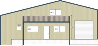

Sorry, rainy day so no real pictures, but here are some elevations:
I once lived in a house with concrete steps that leaned over at an odd angle after a few years so I'll just build some out of pressure treated lumber that should be lighter and, after a little paint and anti-slip tape, should look and work well.

I'm curious what the 3ft drop gets you? Is that to increase the garage door height for something like an RV?
Seems like a pain to climb up and down otherwise.
Personal preference here but I like the look of overhangs on the roofline so then you can have gutters. Maybe your drawing just omitted them for simplicity.
Also it looks like the overhead doors are very close to the sidewalls....which can diminish your ability to store things along those walls and still drive past. With the double lifts seems like most of the work area is going to be concentrated in the center.
Looks like a very nice property there!
P
pmiranda
Jul 15, 2008
1,504
Austin, TX
The 3ft drop is pretty much laking lemonade out of lemons. The ground drops 3 to 5 feet across the building, and the slope of the roof drops 3 feet over the 12 foot leanto width, so I thought I'd rather be able to store an RV or (more likely) a tow hauler with a roof aircon than buy 20+ yards of fill!
The building does have a minimal overhang for gutters, which will be handy given that I expect some runoff from the south and I thought I might do rainwater collection for irrigation at some point.
The OHD's are 2 feet from the sidewalls. My goal is to maximize vehicle space in the width I have to work with. For other storage, I'll probably do what I have in my garage now: lots of shelving, and if that doesn't cover it, a mezzanine along the back wall.

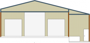

More pics from yesterday:
Cut down at the top corner some, but not so much that it'll take out nearby tree root systems or require a retaining wall:
After the main pour is done, the leanto will be to the side. Can't cut much at the top end so 3 feet is probably about where it will end up being down from the main slab:
Bottom corner is a good 5 feet above ground:
So the back will end up looking like this. I hope I never need to go out that upper window, which is why the stairs will have fire-rated separation from the shop, if I ever get around to building a mezzanine:

I get wanting it above grade elevation, but looks like you could cut it (less concrete).
How many beams are you doing on that slab?
Unsolicited advice: Span that building in electrical conduit, at least 3-4 places inside to inside.... 1-1/4 gives some pretty good options and you an even shove PEX into it in a pinch. Throw some under the slab too in case you ever need to go "through" the building without having to cut around..
P
pmiranda
Jul 15, 2008
1,504
Austin, TX
Beside the perimeter (which has all the support for the metal building since it's clear-span) there's at least one beam down the middle. I forget if the contractor was planning more but I've showed him where I'm putting heavy equipment. I'll go out in the morning before it rains to see how far they've gotten.
Yeah, I've got one big conduit from the main panel on the south wall to the subpanel on the north corner. From those two points all the electrical runs are not very long, and nearly all the 240V loads are within 10 feet of them.
I've got cold water to all four corners.
