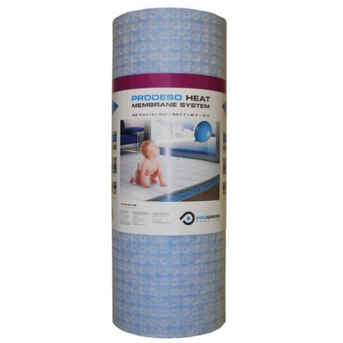

Doing a bathroom addition currently that will have in floor electric under tiles and I'm planning to use this system w/ the Prodeso decoupling mat. Order the wire to the floor size and "custom" make your heating element to the space.
Like PoorUB Mine will be on a wood subfloor over a crawl space.
