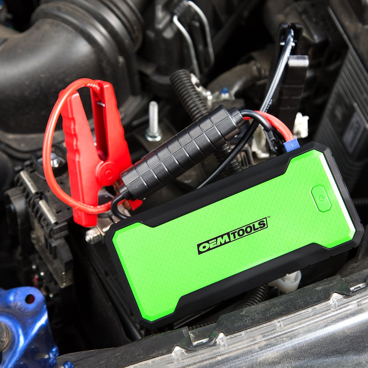

https://www.amazon.com/dp/B074ZKGVQN/?tag=atomicindus08-20
My work truck w/ a v10 died one day and I borrowed one of these from a mechanic to jump start it. Worked like a charm. I'm not sure if he had the 8 or 12,000 mah, but for the extra $8 the 12k might be the best bet(they're out of stock now, though).
Edit: The listing says this is good for up to V8 5.4L, so not sure what you're trying to start.

That looks like mine but a different name and color, including the container. Probably the same manufacter. However, mine is rated at something over 6.2 liter because I wanted it to be able to jump larger v8s. I forget the brand off hand. The nice thing about it is that it is a lot smaller than those large jump pack/stations.
