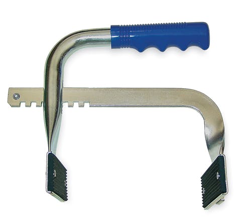

What I was thinking was to figure out a way to put two of this style together. This is the type I use and it feels a little iffy picking up a group 65.
I suspect they're not all created equal - which is why I linked to the Blue Point one. The pads on the one the shop had 40 years ago were actual rubber and group 65 batteries always seemed secure. Thinking back though, I don't think they're idiot proof - which is probably what's wanted if OSHA is involved.
Picture for reference.
