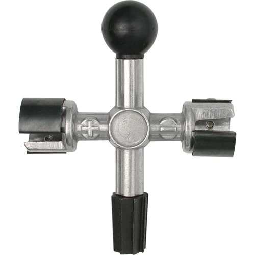

I'm partial to the shaving style cleaners. Just got this from JDTCO to back up my 50 year old Snap on. $13 shipped.
Ooh. I like that.

^ The battery post/terminal cleaner in your first post has been around at least since the 1960s. I've owned several of them. Also sold at least a dozen different brands. Some are pretty good - Indestro sold a fairly decent model - some are worthless: Wilmar (now "Performance Tool"), Zomax, Medallion, Hollywood Accessories all sold them, and they were all cheesy and effectively useless after about half a dozen uses.
The four-way metal job with the cutting blades is a favorite - there are really spendy models, and really cheap models, just as with the "brush" in your first post. (They are not as popular a seller as the "brush" model in your first post.)
The "pliers" work great for spreading the terminal end open, but other than that they are not as good for cleaning either the post or the terminal end.
