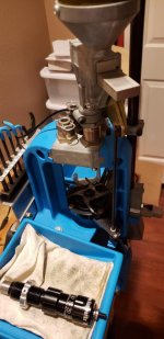

Next came time to “accurize” the heads. The heads on a Dillon slide into place and are retained by two .125” pins. This makes for quick toolhead changes, but allows for a few thousandths of upward movement when cycling the press. This movement can cause variances in your brass during the case resizing process. To alleviate the movement, each die head was drilled, tapped, and #5-40 helicoils were inserted. This allows for a screw to be used to cinch the heads all the way up, removing the play. As the heads are pulled up by the screws the top surface of the head sits slightly proud of the top surface of the press causing interference with the screws/washers, so a minor relief was milled into each side.
Attached is an image of the Dillon in "stock" 9mm configuration using on press priming and powder throw as Dillon intended. If you look close, you can see the standard .125" pin's head below the powder measure.

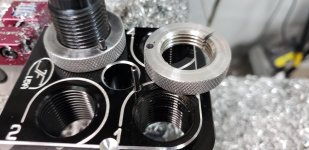

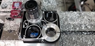

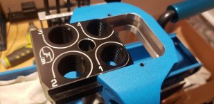

The next theory is that allowing your dies to have a little bit of wiggle or “float” allows them to self center reducing runout. Reloading dies are usually threaded ¾”-17, so they will move in the threads until tightened all the way down onto the lock ring. If your lockring isn’t flat, or your press/die relationship isn’t perfectly inline, then any variance will show up as runout. To allow the dies to “float” you pin the lock ring to the head, which prevents die rotation, but still gives you that aforementioned wiggle to allow the dies to center. All play comes from the slightly larger hole (#31) in the lock ring than the 5/64” spring roll pin (#43 roll pin hole).
I chose to use all Forster brand lock rings as they are wide, easy to drill aluminum, and clamp tightly on the dies. For those looking to do this, I found a good location to drill for the roll pins was .280" up/down and .280" over from the center hole in the toolhead; in other words they are on a .560" square pattern.
Only 1 die is pictured in these images. Holes #1-3 will all be used, and #4 will also be used for gas guns that require a crimp die.
This particular toolhead was my test mule. The relief for the screws is larger than the rest because I was covering up a spot where I failed to raise my quil and smashed a centering drill into the edge of the toolhead.....rookie.

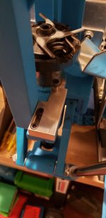

The final thing I did to the Dillon 550 was to remove the priming mechanism that comes on the press. I do my priming with a separate tool that allows for more accurate and consistent seating depth. When removing this, the ram surface is below the surface of the silver ejection chute on the 4th stage causing the expelled cartridge to jam up. I made a space that bolts in place of the primer mechanism out of a piece of .500” aluminum scrap and a random ¼”-20 shoulder bolt I had. The ram head comes down and rests on the head of the shoulder bolt.
Maybe someone will find this interesting/helpful. All said and done, none of these ideas are “mine” except for the spacer above. These are all well documented modifications from far better reloaders and shooters than myself. Whidden Gunworks and Uniquetek sell fully decked out heads if you don’t have the tools or desire to modify them yourself. I’ve never personally used them, but they get stellar reviews. The nice part of all of this is there are no permanent mods done to the press and I can return it back to a 9mm machine in 10 minutes. I would say the hardest part of any of this was having to reverse engineer the head dimensions with calipers and an edge finder. It also took some experimenting to get the correct drill sizes for the lockring pin arrangement. The 5-40 helicoils are definitely a lesson in patience…...I don’t even want to get into that.
Reloading processes are unique to the guy performing them, but here’s my plan for this setup:
Deprime on a single stage Redding Boss with Lee universal decapping die. The single stage is super quick for this due to it’s short throw. It also keeps the carbon deposits off the Dillon, which wears on the ram shaft.
Dry tumble in walnut
Full length size on Dillon 550 in station 1 with no expander ball in die
Run a carbide “turning” mandrel in station 2 to expand neck to .002” under bullet diameter. This station doesn’t require a pin on the lock ring as mandrel dies usually float the mandrel itself within the die.
Trim, Chamfer, Deburr off press using a Giraud trimmer (huge time saver)
Prime off press on a Primal Right’s CPS tool (fast and precise)
Charge powder off press using an AutoTrickler V3 (fast and precise)
Insert charged case on station 3 and seat bullet
Station 4 is either empty or has a crimp die for rounds being used in an AR15 or the like. Rounds automatically eject out of station 4 into an Akro bin.
*I'll continue to add to this post as I get more of my setup put together (dies set, primer tool setup, trimmer, powder scale, etc. I'm waiting on some stuff right now and I've got some more stuff to make as time permits*
