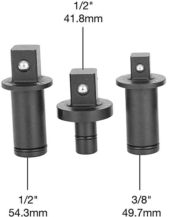

However you have nothing to "receive" the item you are pressing out? You are also without a press ram-extension, leaving you to space your ram down with sockets, or constantly raise/lower your base plate?
For ram extensions, we have some adapters from an old brake lathe. Various sizes, works great. Something like these.
https://www.amazon.com/dp/B07MJTW1Z4/?tag=atomicindus08-20
https://www.amazon.com/dp/B00WXMUXM8/?tag=atomicindus08-20
https://www.amazon.com/dp/B015EEWUVI/?tag=atomicindus08-20

The holy grail tool for me would be an adapter to fit my Snap On BJP1 that has a 1/2" ball-detent anvil on it to hold sockets!
OEM includes them in their C-frame socket set but I can't find them by themselves, much less made to fit the BJP1.
