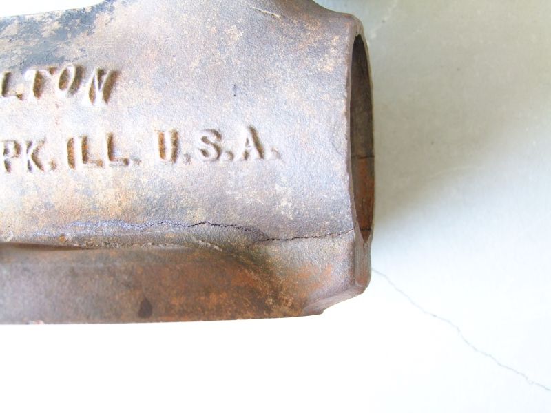

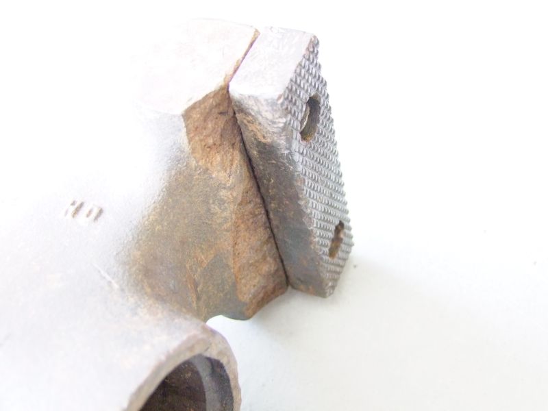

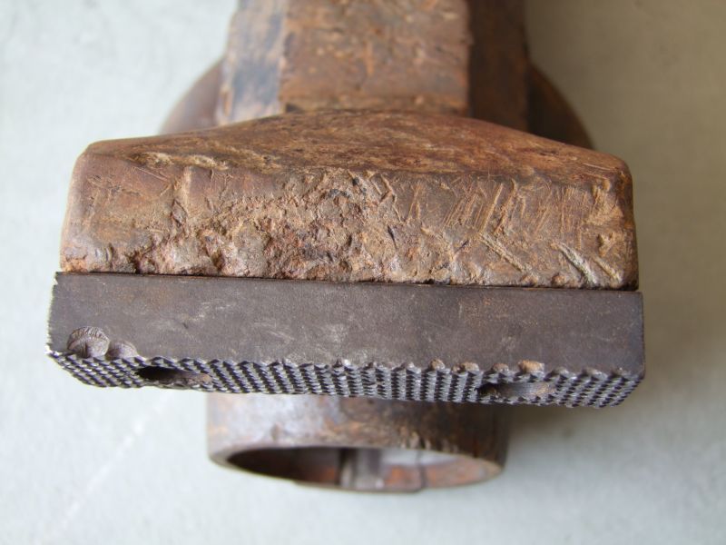

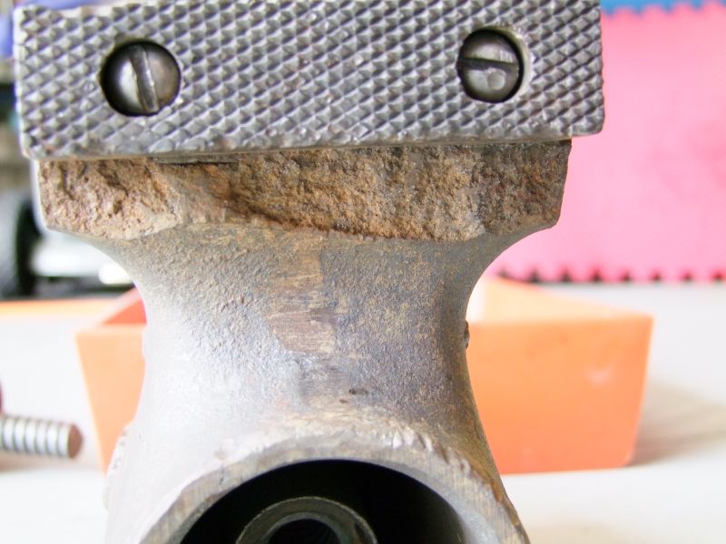

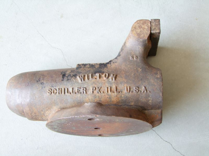

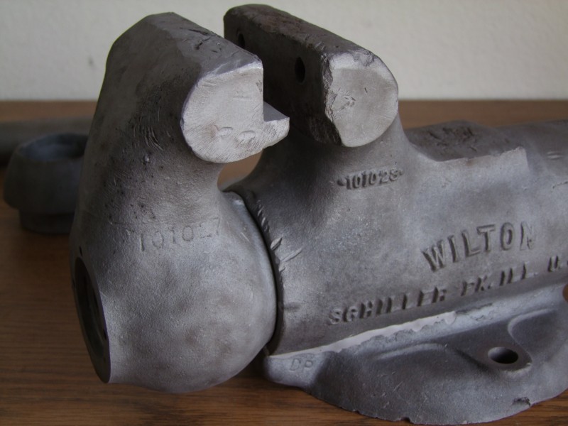

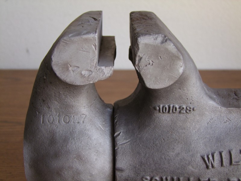

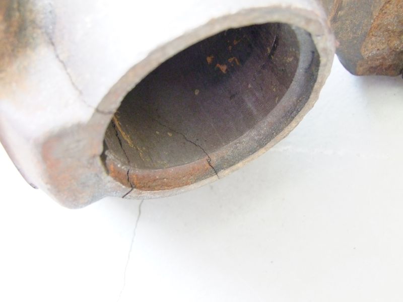

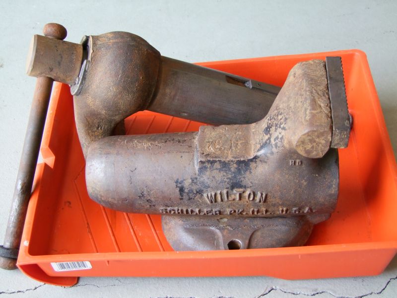

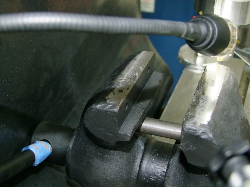

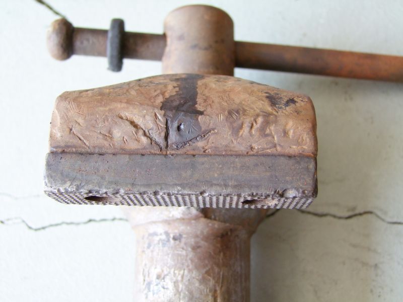

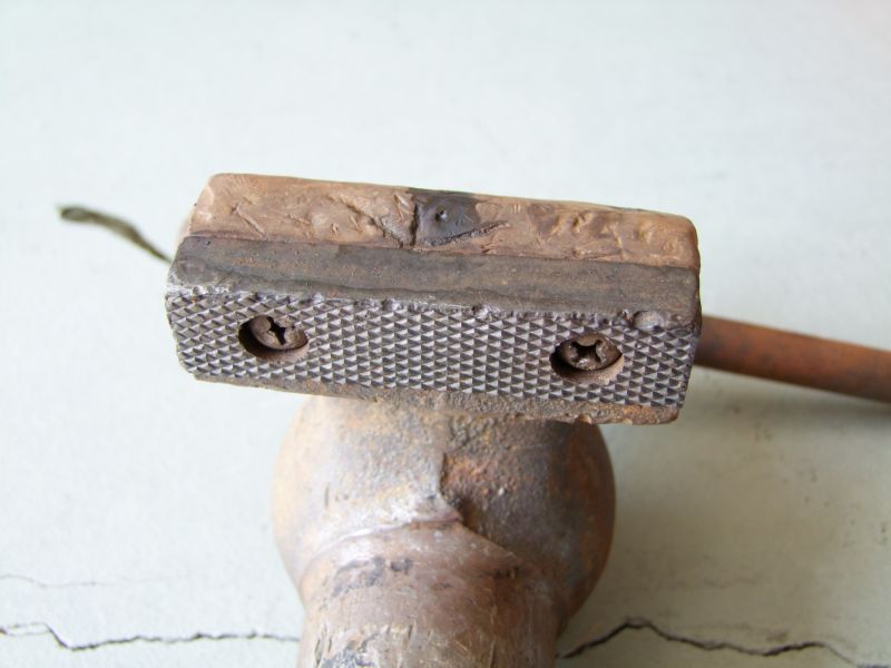

Just picket up this yesterday from an older and retired man in city (via Craig's List) for $60. Moves fairly smoothly, but it has been severely beat-up. I have not seen a "tool" so poorly taken care off.
Here are the photos posted in Craig's list:

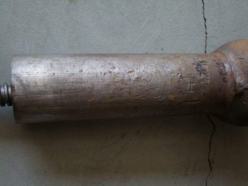

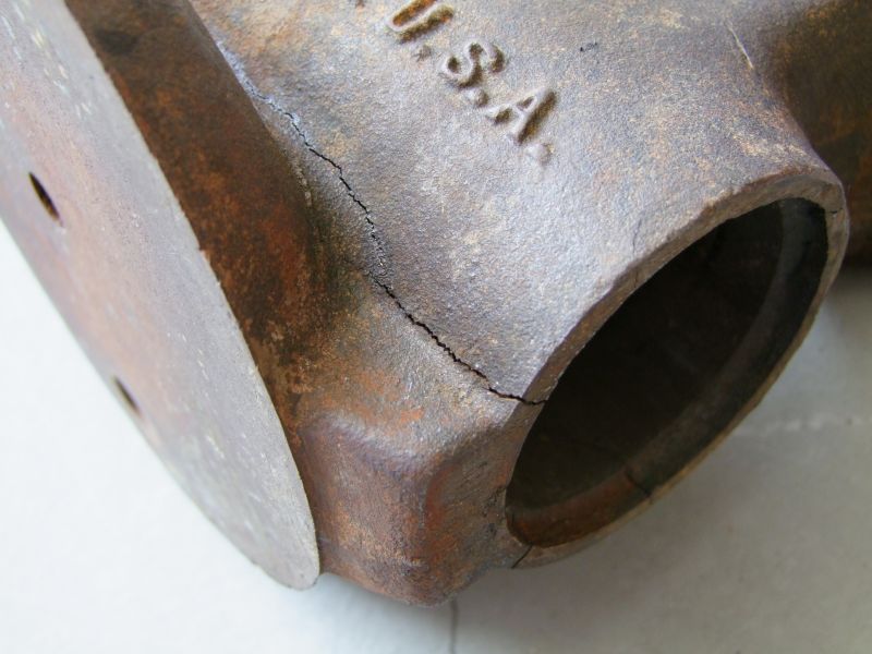

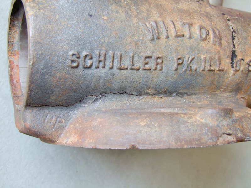

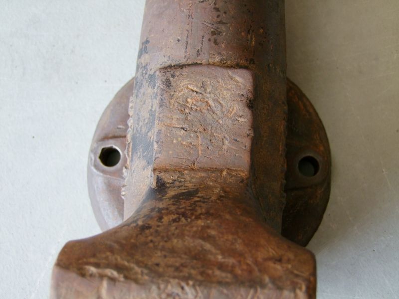

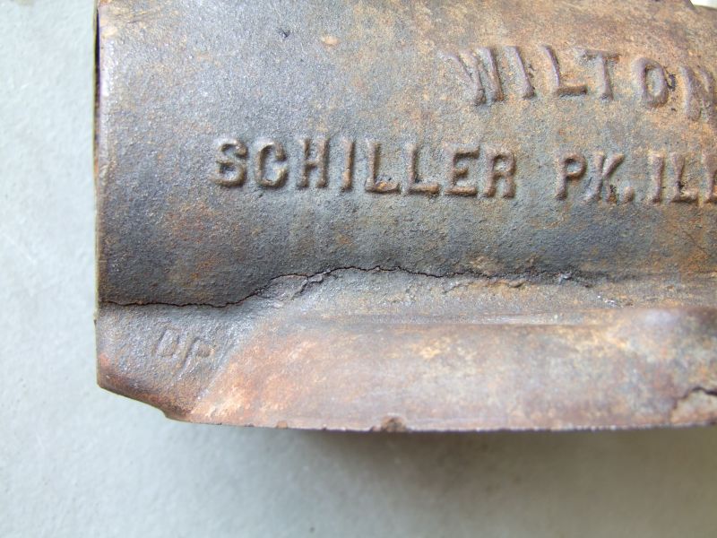

And after a little bit of cleaning, you can see how bad it really is, including a couple of cracks on the fixed jaw/base side:

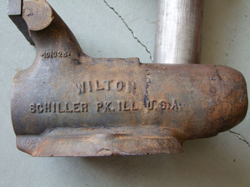

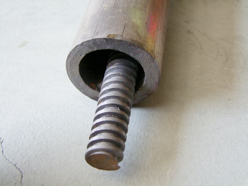

The hard jaws are exactly 4" wide. Both jaws are miss-aligned, and all 4x bolts holding the jaws were bent. The lower portion of the fixed jaw has broken/shear off:
The stamping reads 1173, so this was manufactured on November 1973 (model on base is 101028, and I think it reads 101027 on the movable jaw), so it is almost 40 years old. It seems that the poor thing has been abused all along - almost as if it was abused on purpose. It appears it was hit on every surface, from every possible angle:

Just my opinion but I would not try to bring that vise back from the dead. Broken jaw supports one can get by with, a cracked lower casting will be dangerous and could make that front jaw assy. give way should you be holding something heavy. Steel toed shoes might not even save that mishap.

Thank you guys. If I had noticed the cracks "before" I bought it, I would had walked away from this one. But lesson learned :thumbup:
I need to find a local welder that can weld cast iron, and of course for a reasonable cost. If not, I will consider the old JB weld to at least have a usable small vise in my "shop" until a better Wilton can be found. If/when I have updated pictures I will post them here again :)

Yeah, a good learning tool for welding practice. You can learn the in's and out's of heat treating cast iron before welding so as not to weaken the other areas of the cast iron, that sort of thing. And you would need a stick welder for that. If you get GOOD at it, you can move up to cylinder heads and that's where the money is with welding cast iron, if you're good at it. :) BTW, do they even make cast iron cylinder heads anymore?
But don't try to weld it and then sell it because buyers will be tricked, as you have been. Even telling them about a welding fix doesn't mean it is safe to use, but they might think that's what you mean.

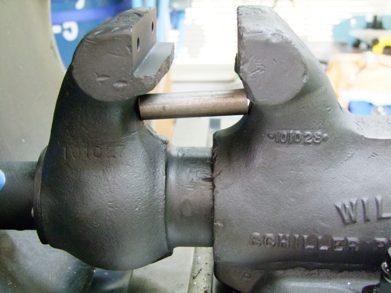

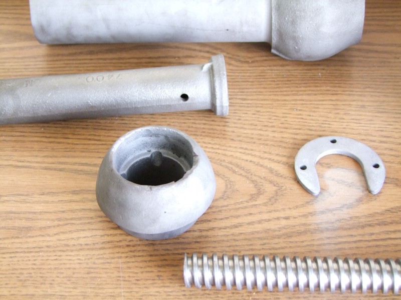

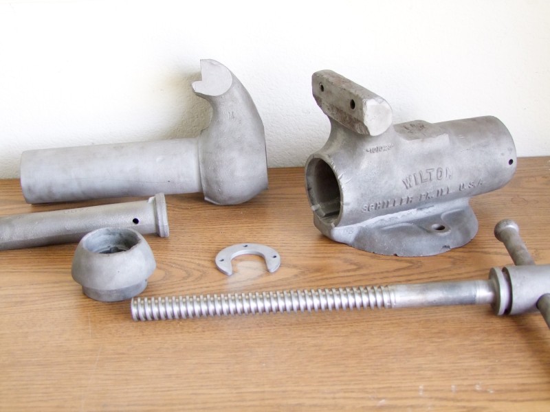

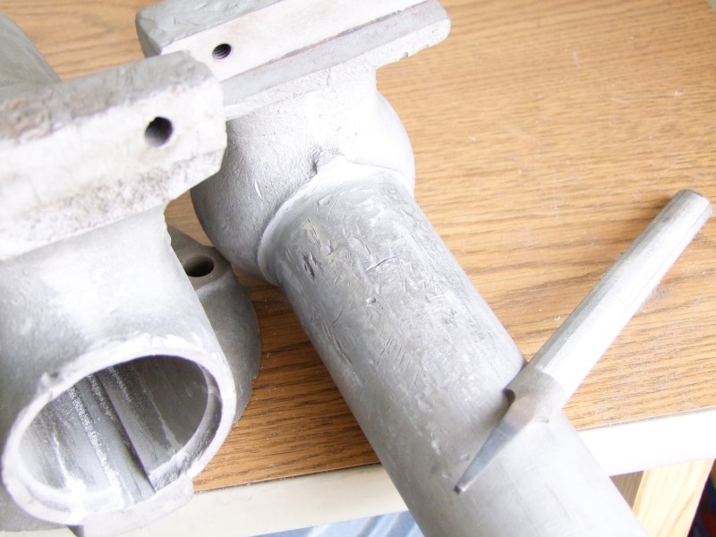

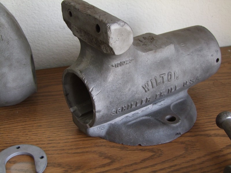

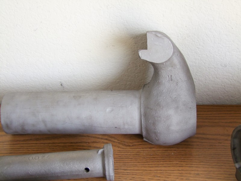

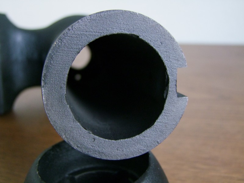

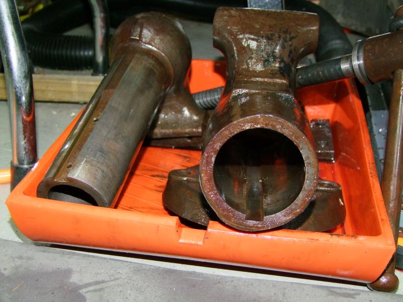

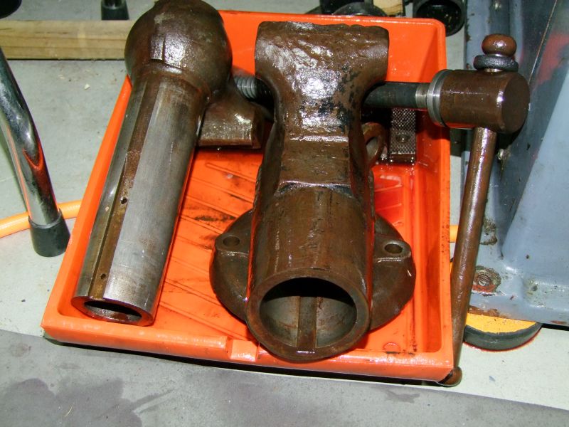

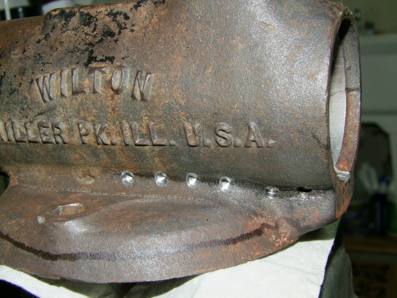

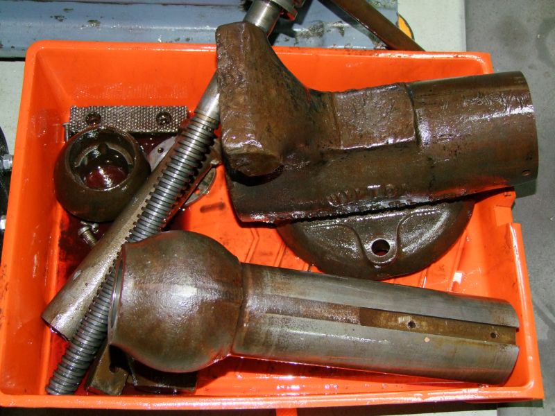

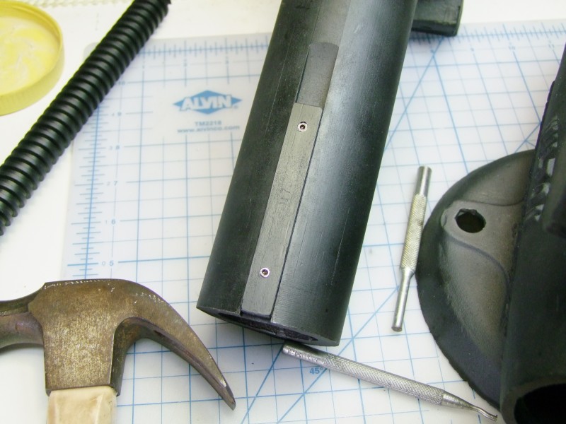

OK, so after disassembly, I started by cleaning the vise some more:

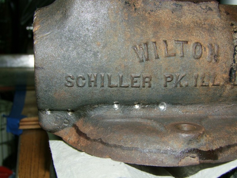

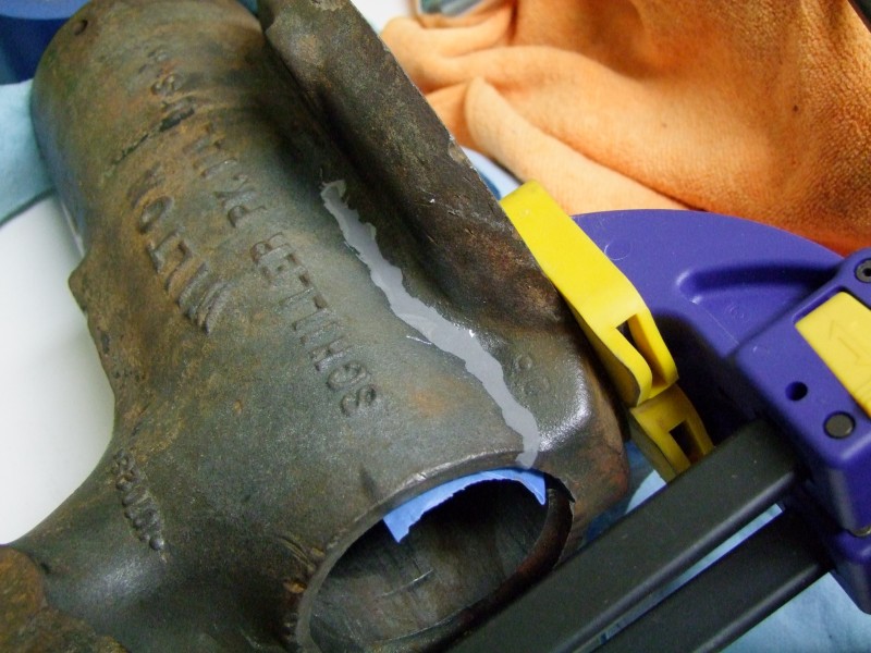

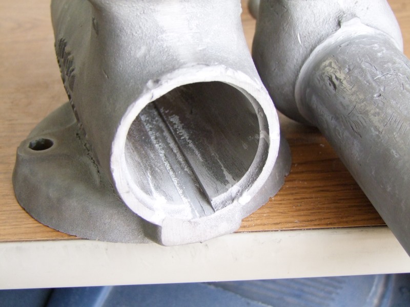

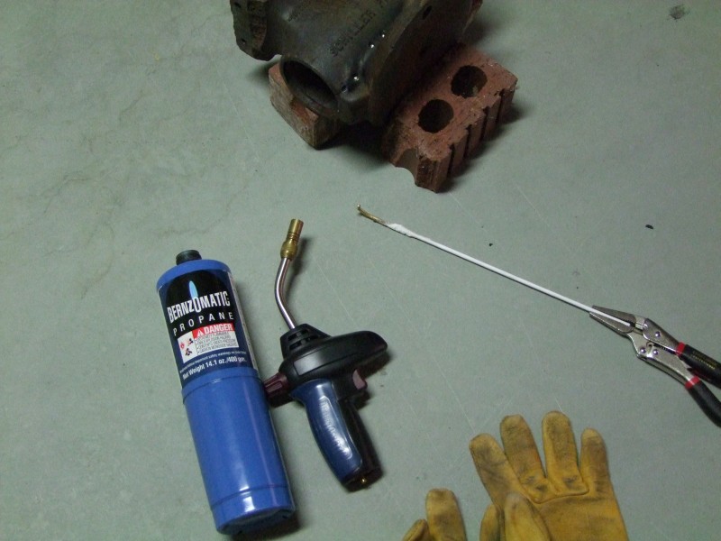

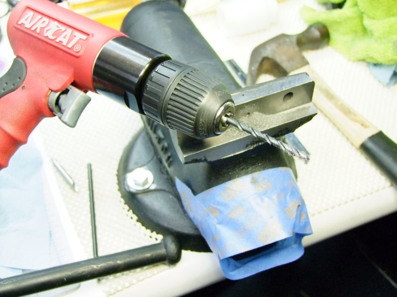

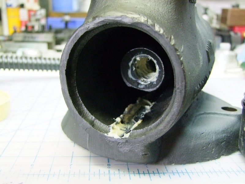

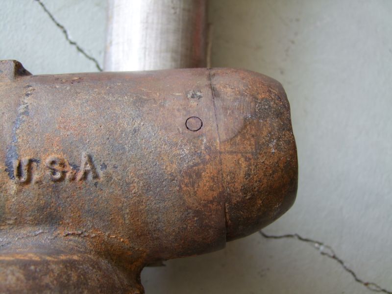

Then I drilled some holes along the cracks to fill-in. Initially I was going to braze, but ended up using JB Weld:
I then sand blasted all parts:

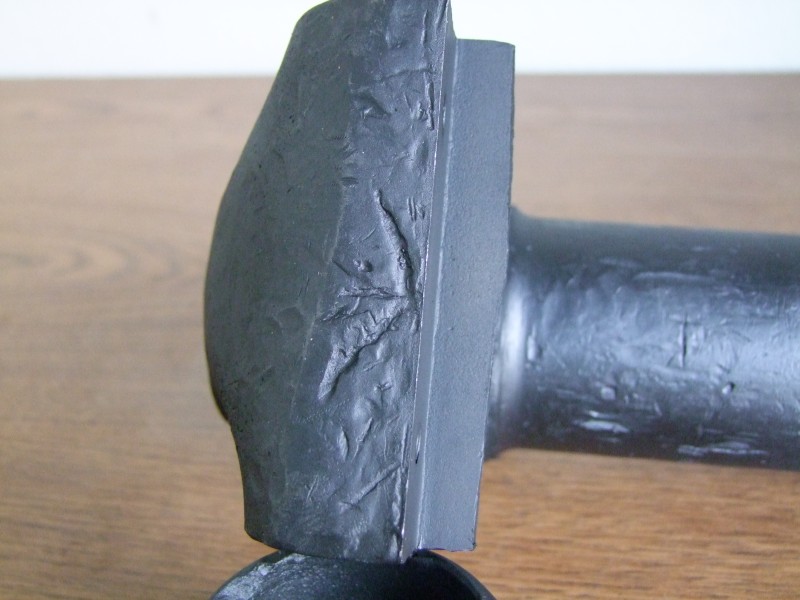

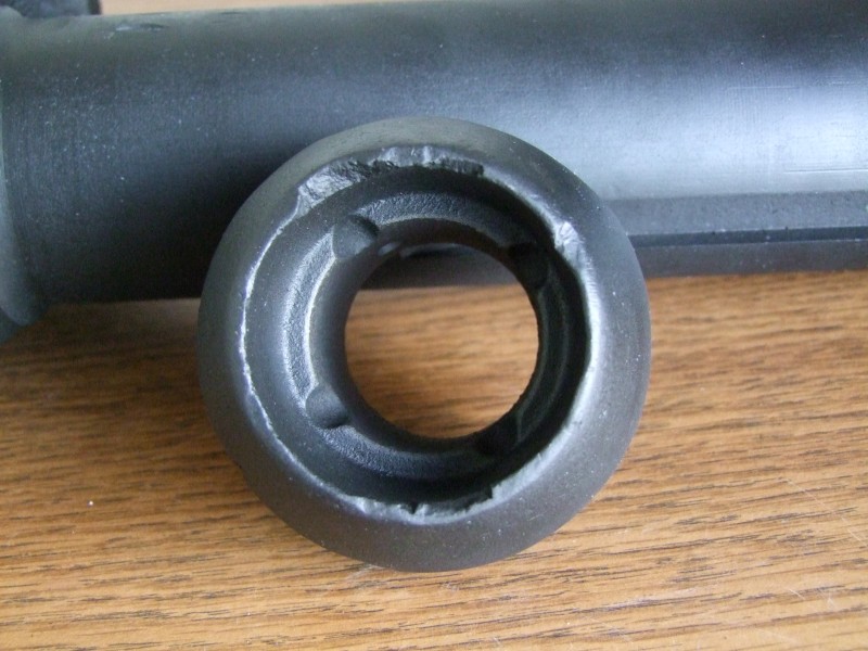

Good look at the damaged fixed jaw. And by the way, all screw holes for the jaws are badly damaged, so I will have to drill them out and start over with larger ones:

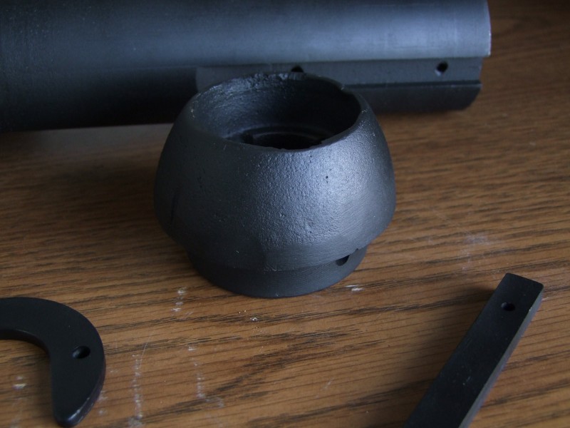

I then filed down the epoxy where it touched the other parts, and also filed down all of the imperfections in the sliding tube (movable jaw part):

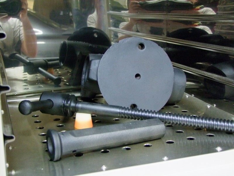

I after cleaning and pre-heating (to 100F, per Norrell's instructions), I applied a very thin coat of Flat Black Moly Resin to protect against rust. I did not want anything thicker as I don't want to hide the vise's last life(s)- I "do" want to show how badly it was treated before.:
I coated parts twice, first one side, when the other side. The screw part was the most difficult to "handle" while spraying:

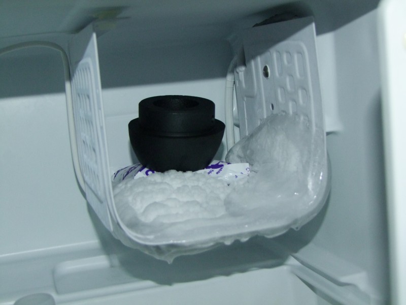

Parts have to reach 300F for at least one hour. The main vise (fixed jaw) having so much iron, took the longest to fully warm up, and it took for ever to cool down afterwards:

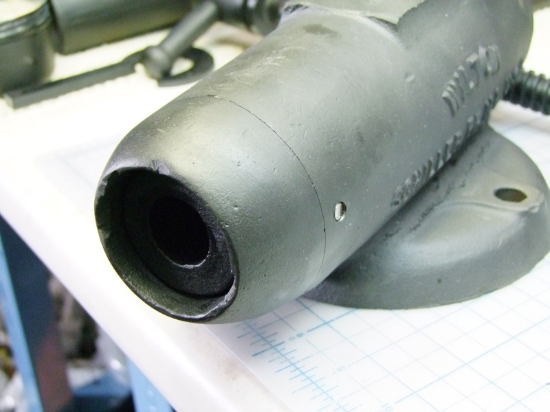

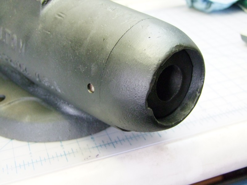

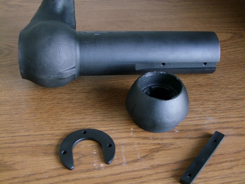

Although it did not help much (it was still a very tight fit) I tried cooling down the back piece:

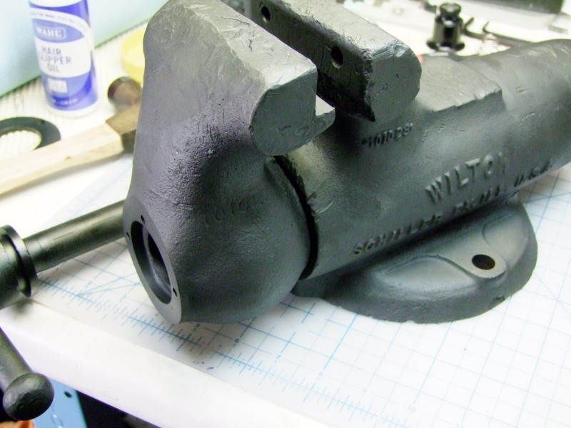

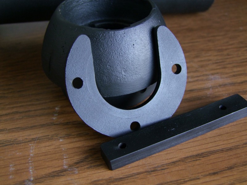

Assembly. Back piece in place:

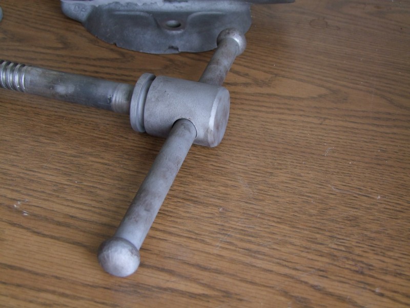

Greasing the main channel and the "screw":

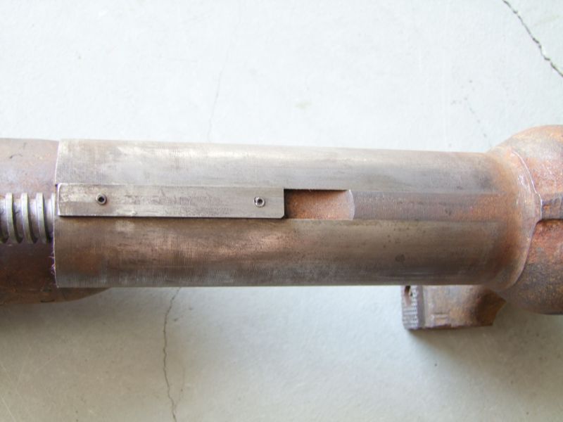

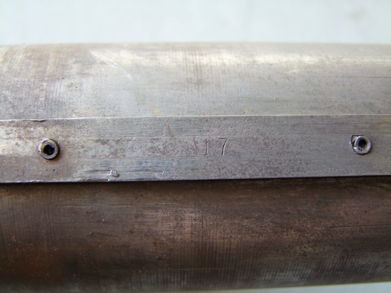

Installing the hard steel guide:
Checking for alignment - excellent. Almost zero rotational play, although there is of course up-down play due to the loose fit of the two main parts:
Finished the assembly:

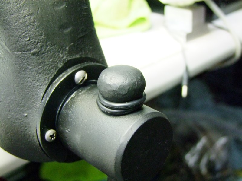

I need to fabricate an end cap to cover/protect the screw from dirt/debris:

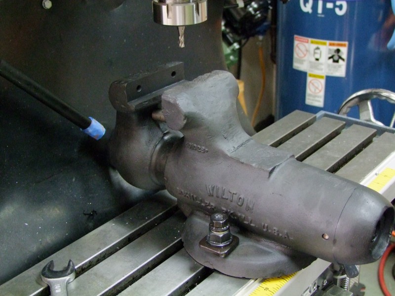

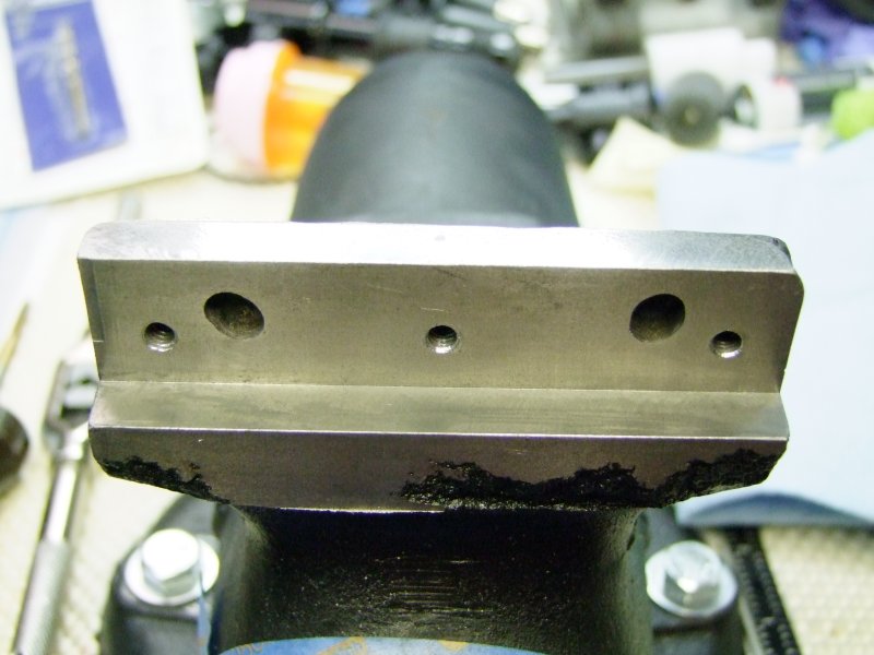

I am now ready for the machining part of this project - to recut/align the existing face, and create a new face for the fixed jaw:
A steel piece under high tension will keep the jaws from moving while they are being machined, a very light pass at a time:

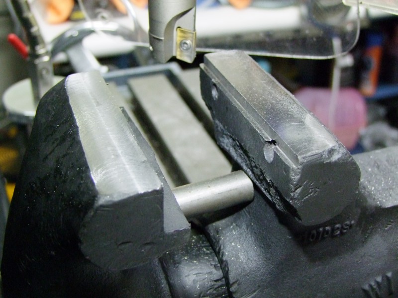

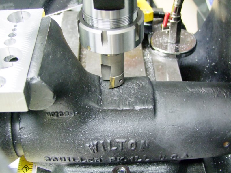

Update: Oct 2 2011
Got some "quality" time with my Walton vise. Making progress ...

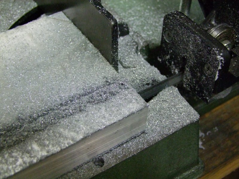

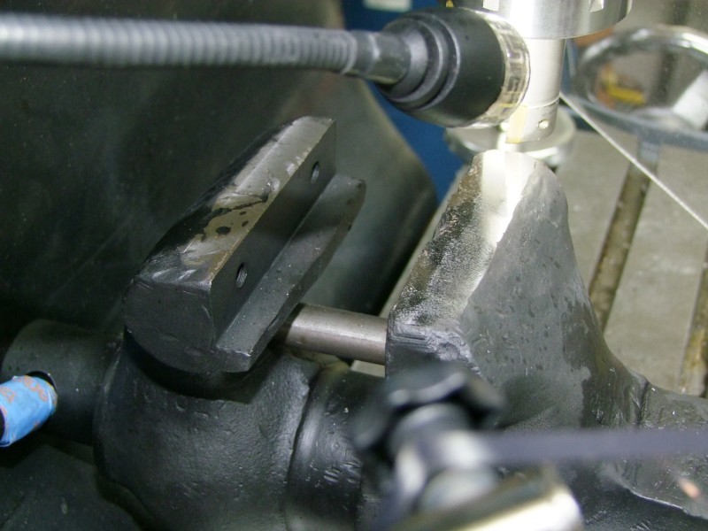

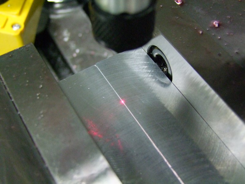

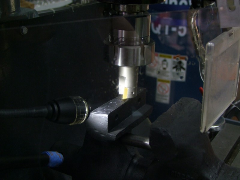

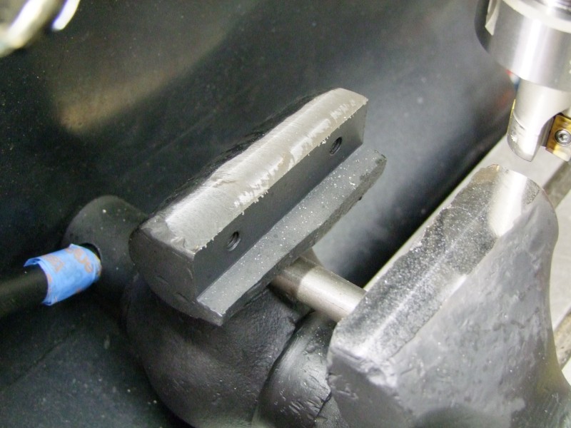

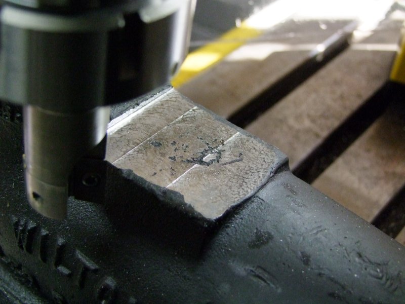

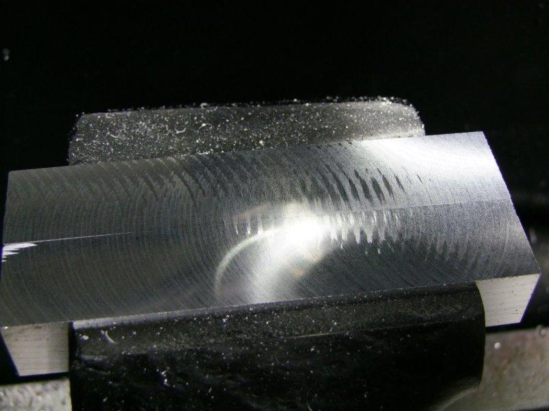

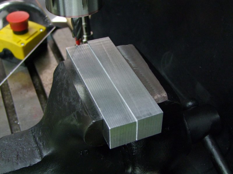

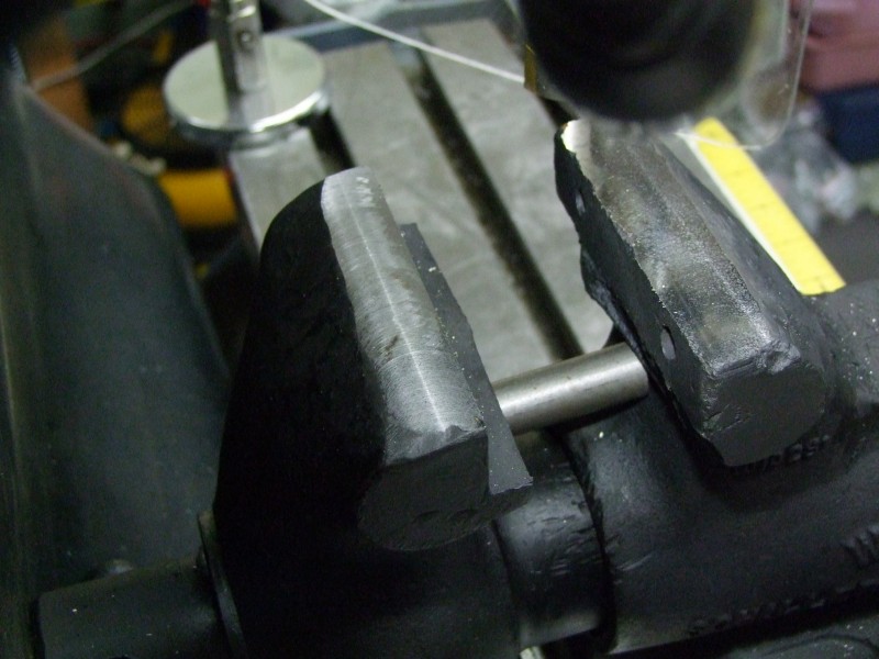

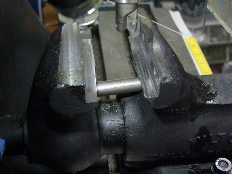

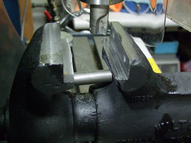

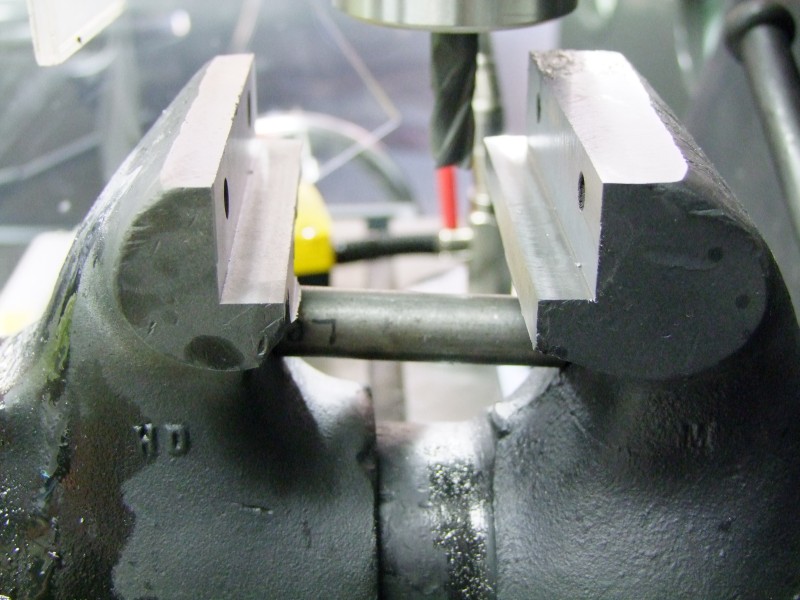

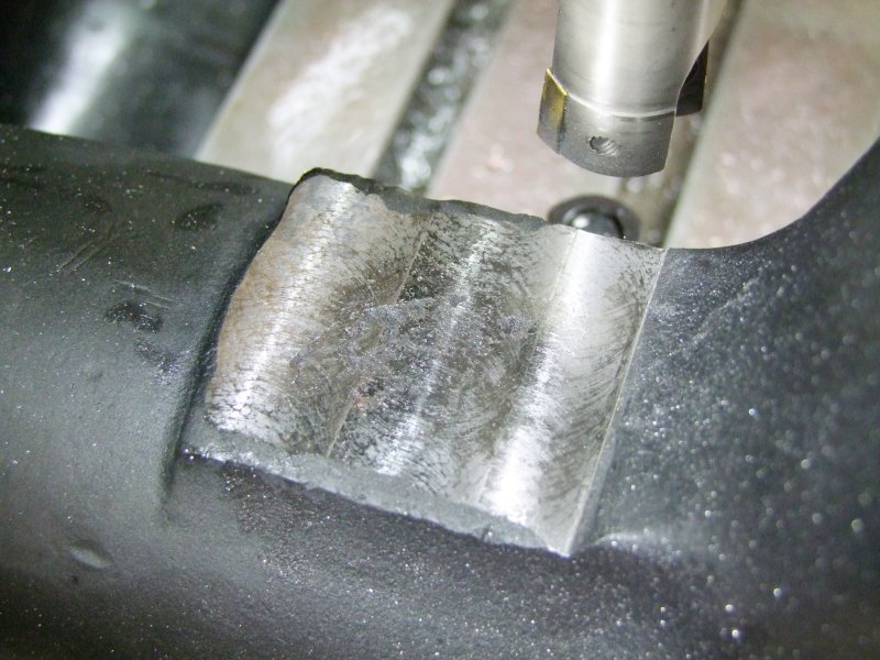

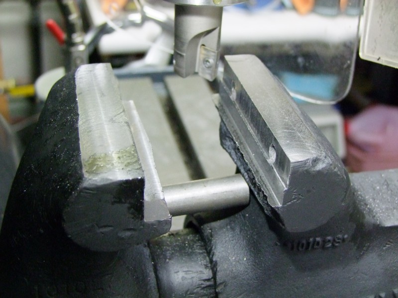

Since only one side had any sort of "face" to use for reference, I used it to align the vise to the table:

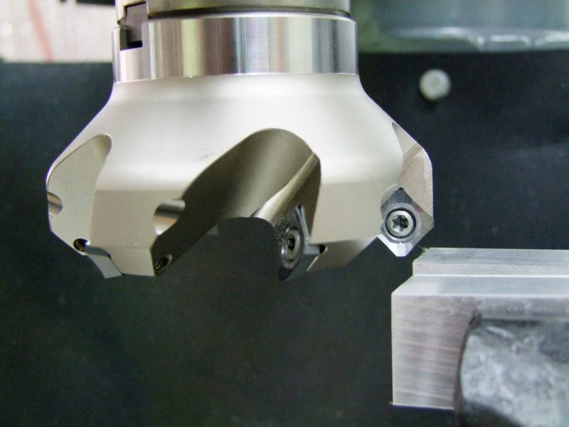

I did the machining of the new faces in two steps. First using a "coarser" insert-based cutter, and a final cut using a sharp, solid carbide cutter. Here I am getting setup to start:
Started on the tops:

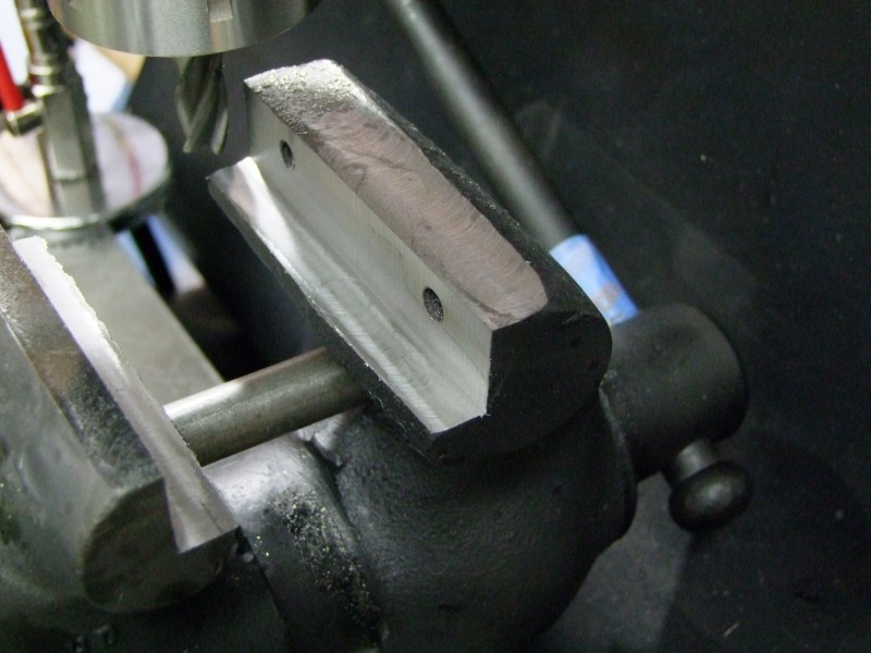

I then started to cut the new face:

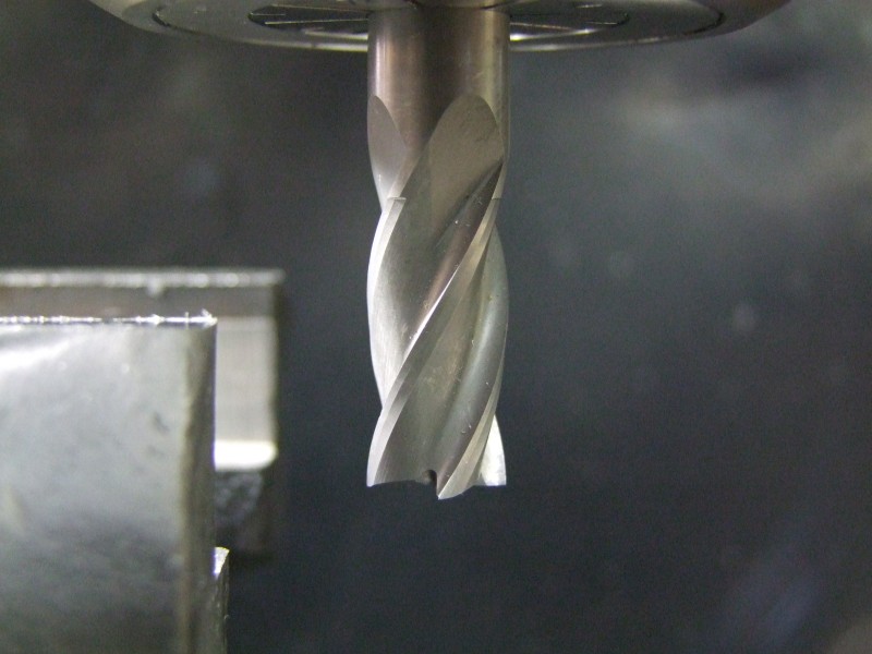

I then get ready for the solid carbide cutter:

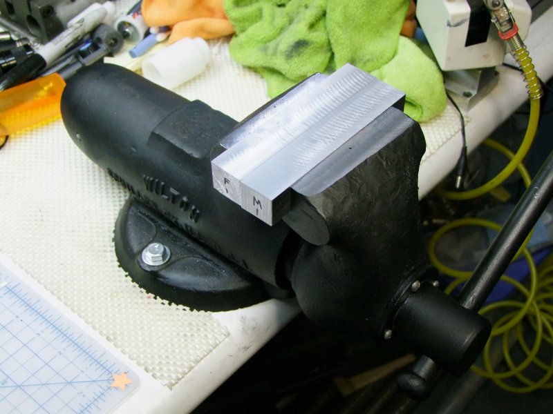

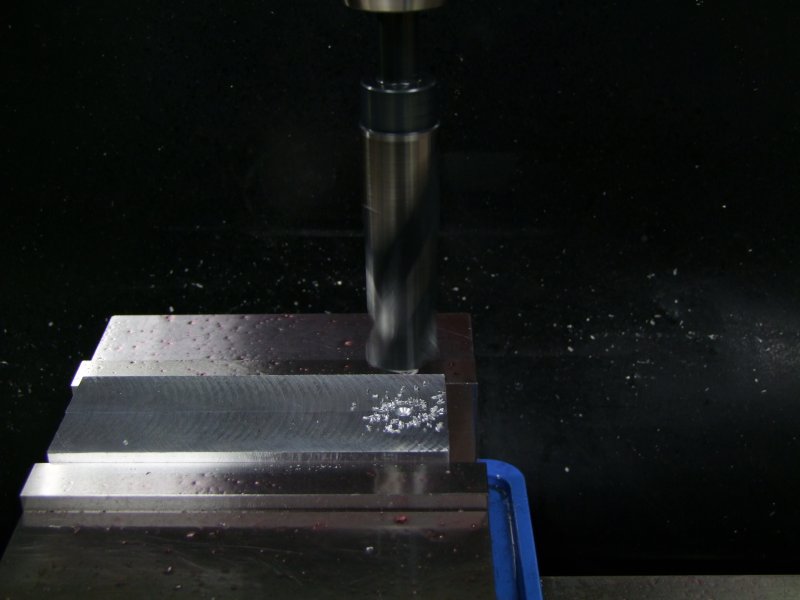

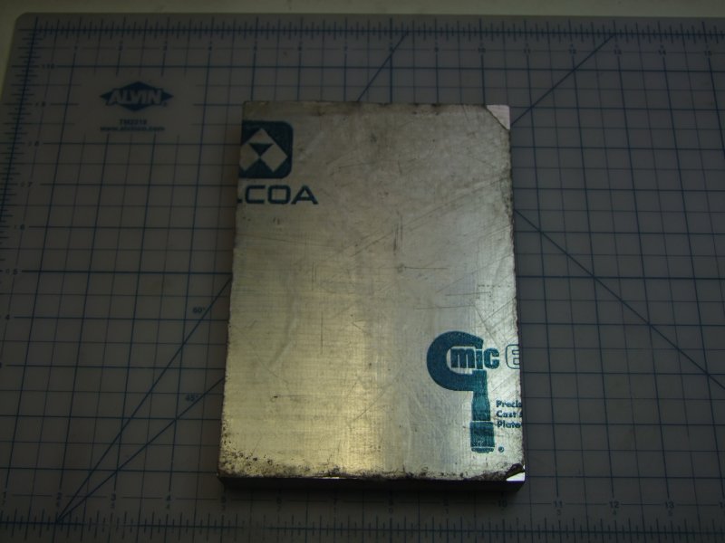

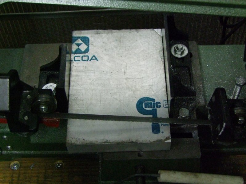

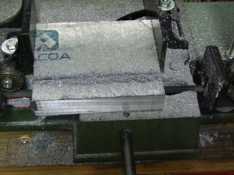

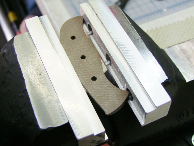

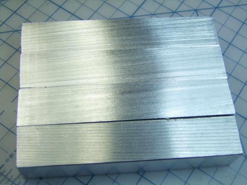

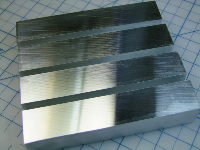

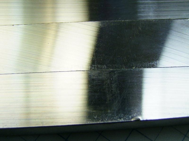

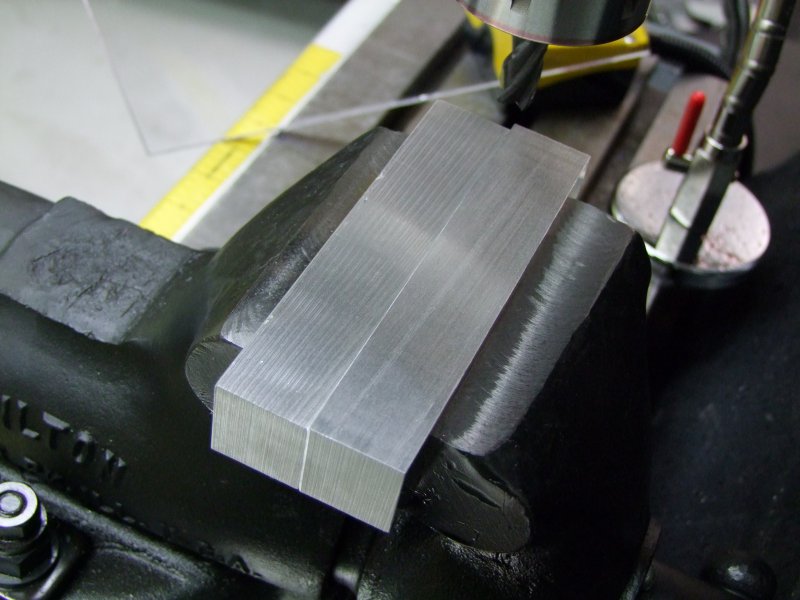

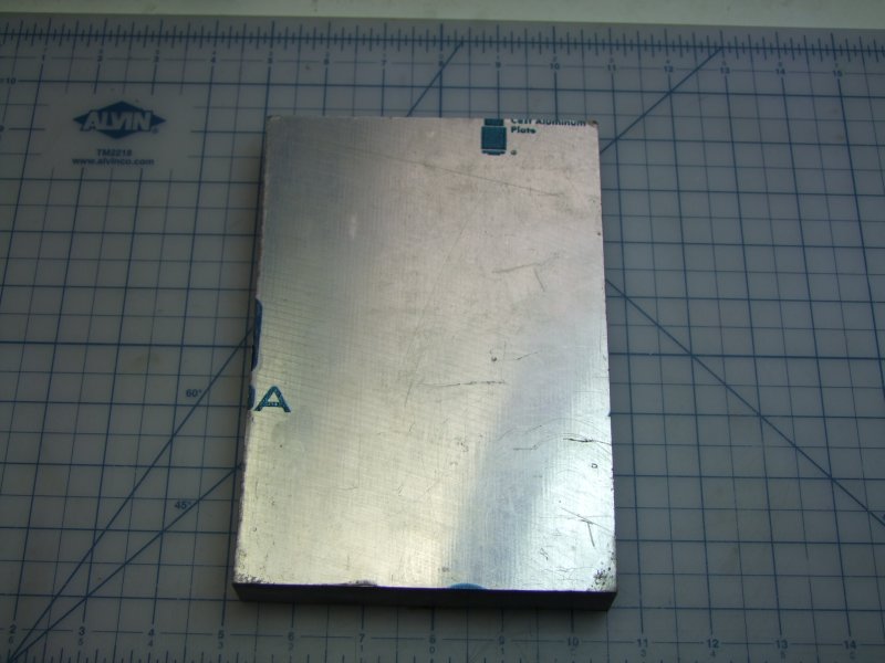

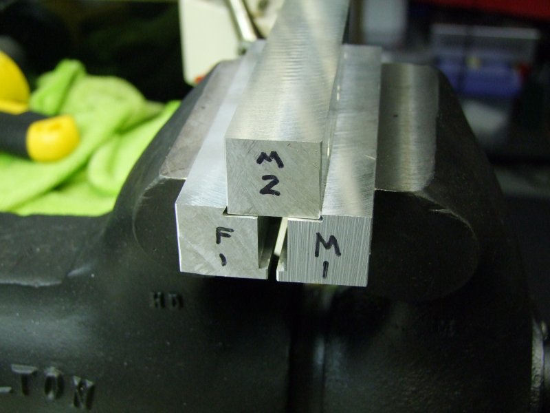

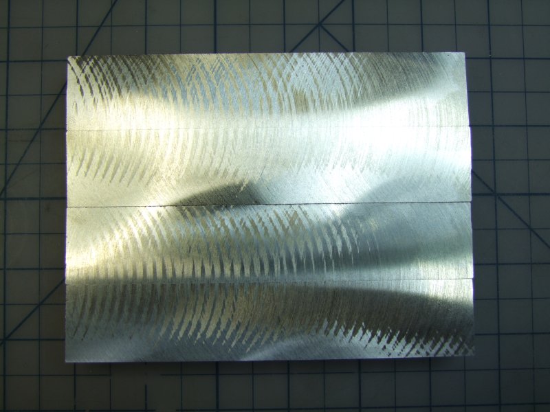

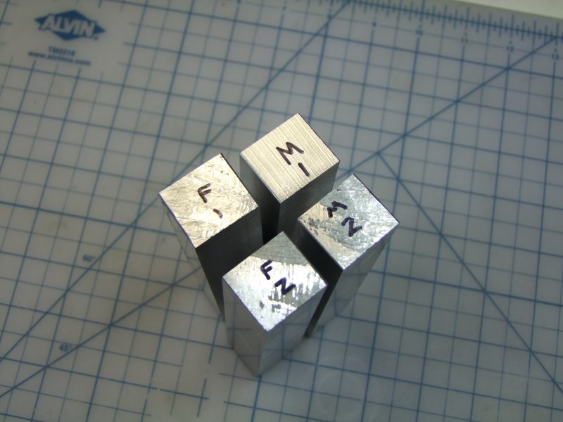

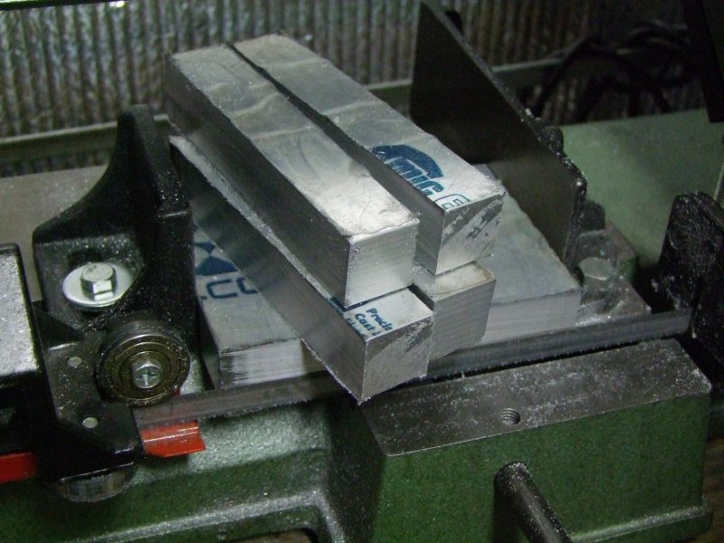

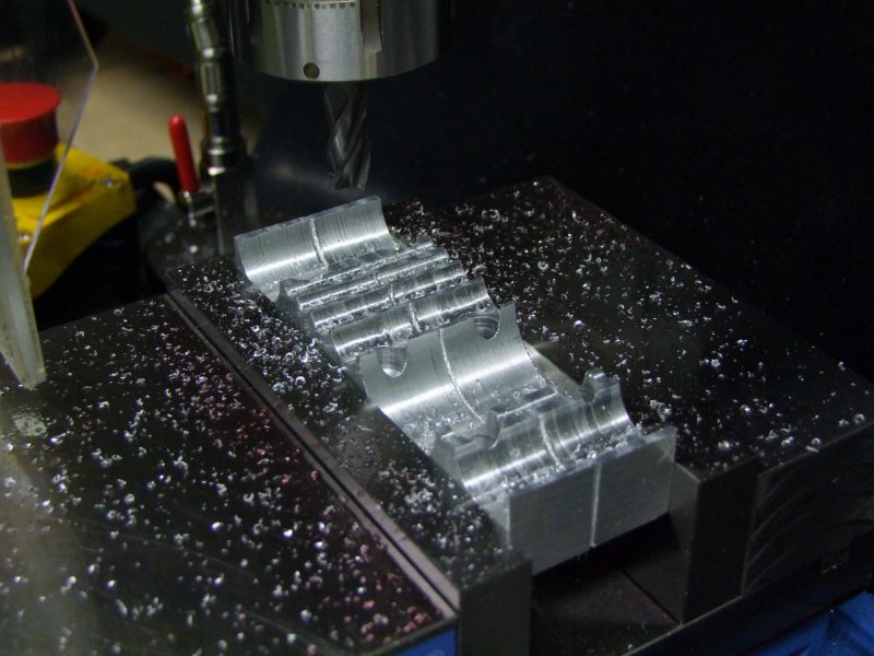

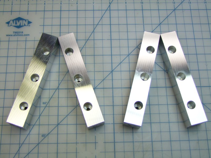

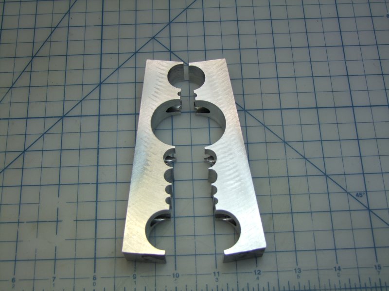

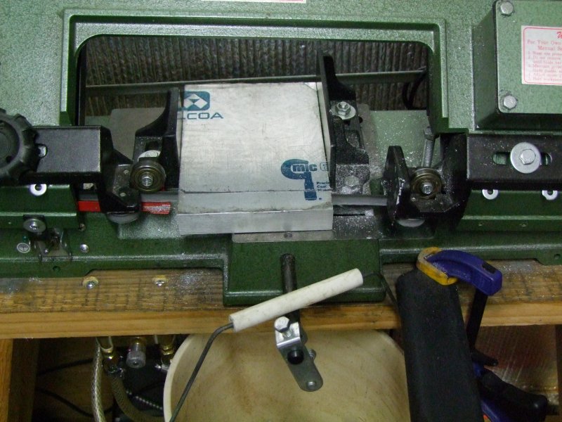

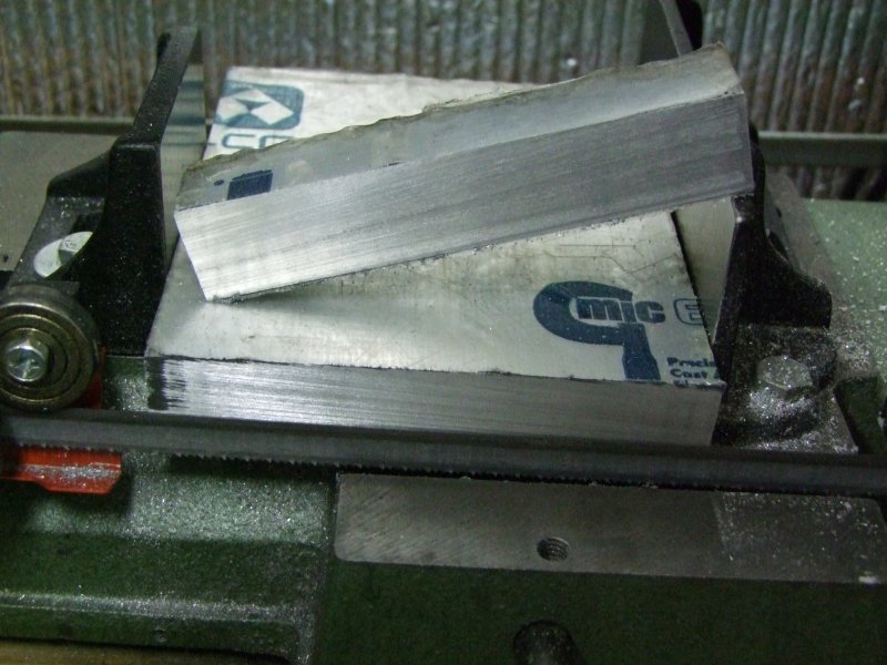

Started work on the soft jaws. Upon a recommendation from Barry, I am using premium Alcoa "mic 6" cast plate aluminum. This piece is 1" thick, and it was a cut-off piece from Ebay - like $10 including shipping:
So I am making two sets of matched soft jaws:
The material cuts very easily:
Here are the four pieces (still dirty):
Once I remove the protective film on both side and clean them, they look like this:
You can see here the cuts I made with my band saw, and the more "raw" cut from this scrap piece (as it came to me):
The top/bottom have the awesome factory smooth look Barry told us about (note this piece has a few nicks):
This is how they look in the vise:

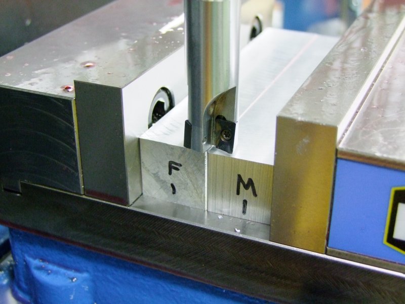

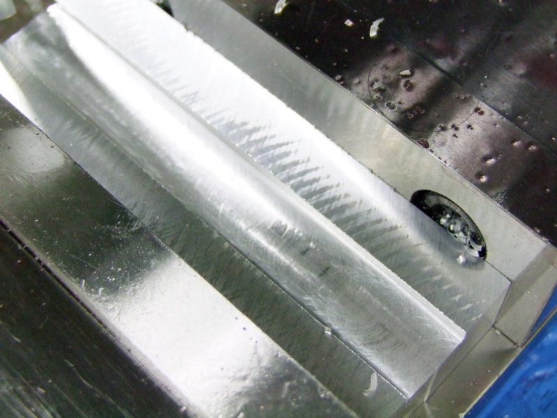

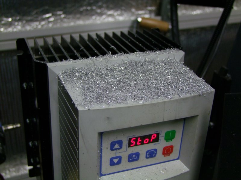

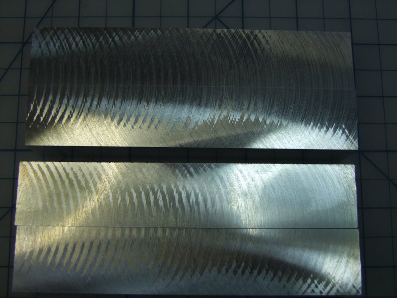

For this job I am using my 2" cutter, with Al-specific inserts (spindle speed set at 1300 rpm):
Not "perfect", but I am getting a cross pattern - kind of hard to photograph:

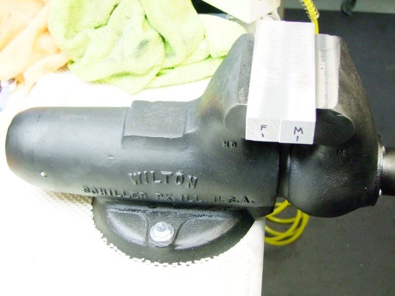

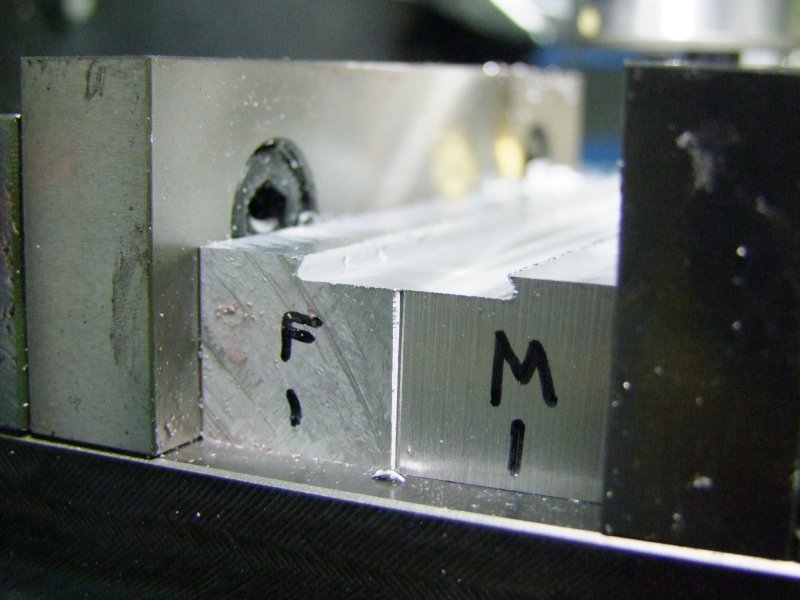

Once I cut them, I marked the two sets (F for fixed jaw, M for the jaw that moves):
And this is why you "need" a NEMA4 enclosure for your VFD:

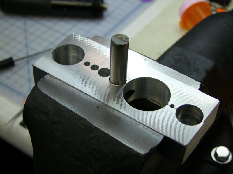

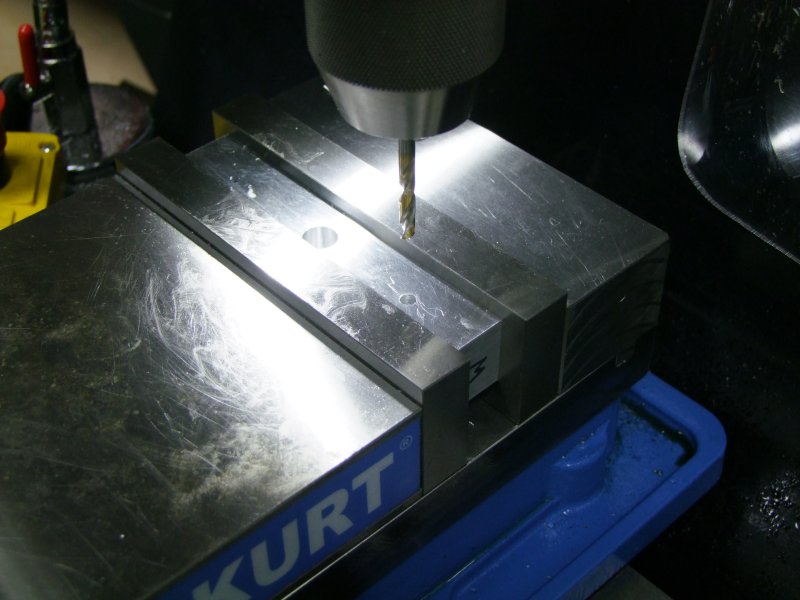

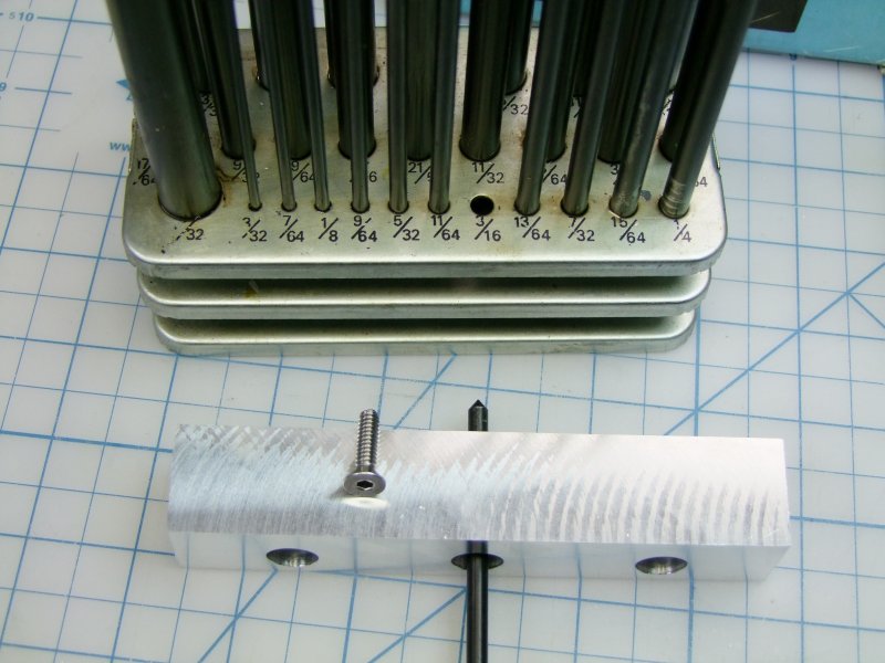

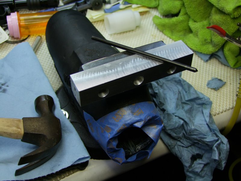

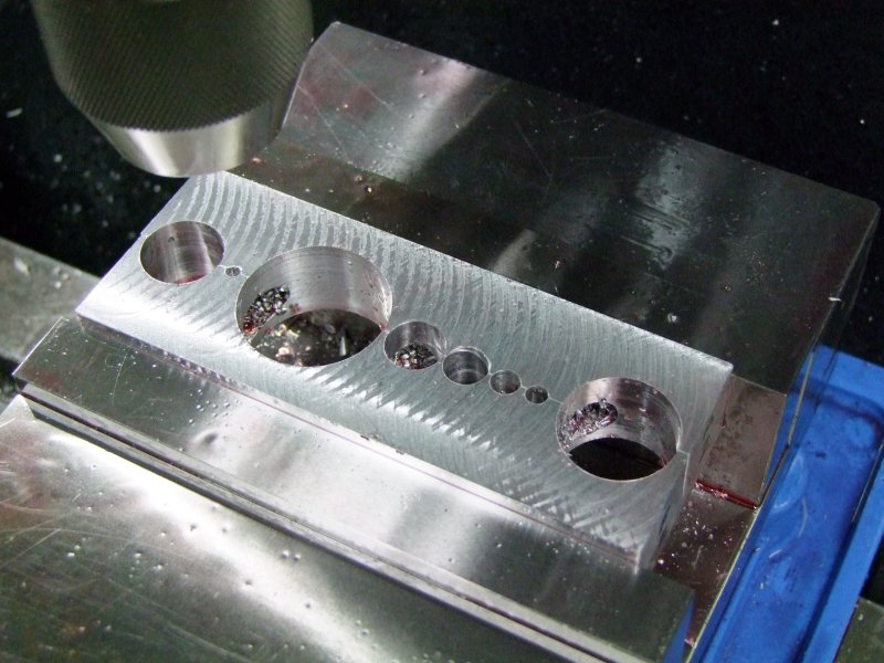

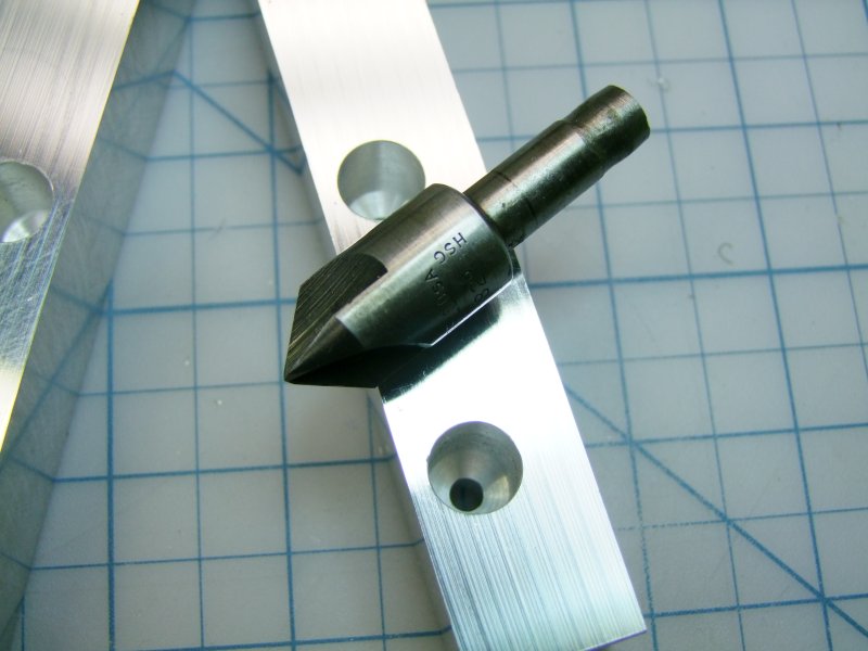

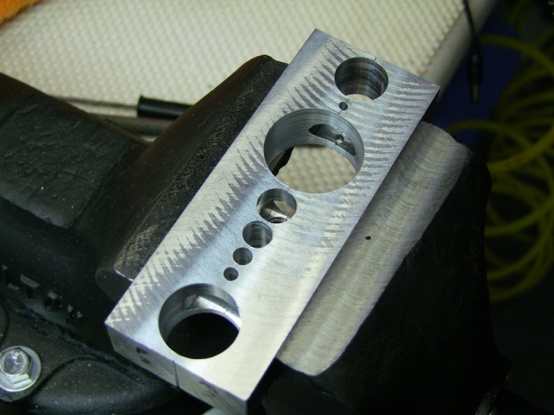

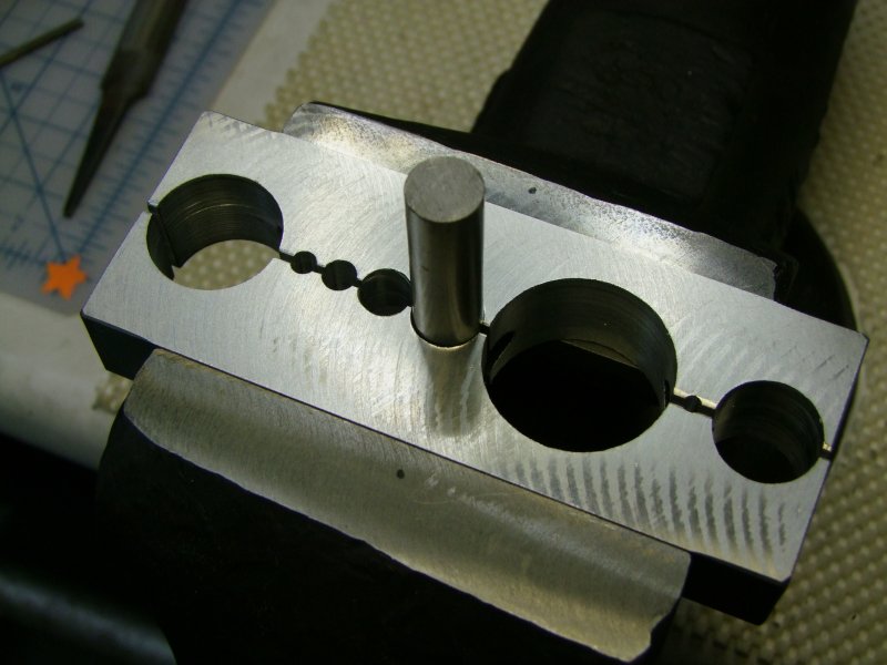

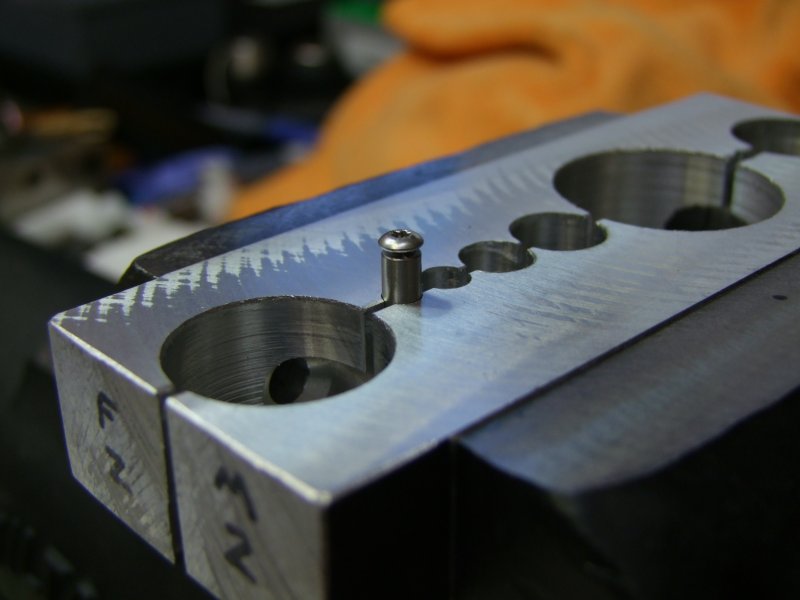

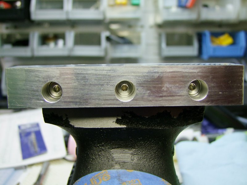

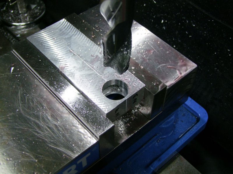

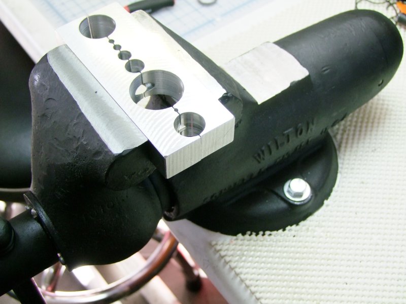

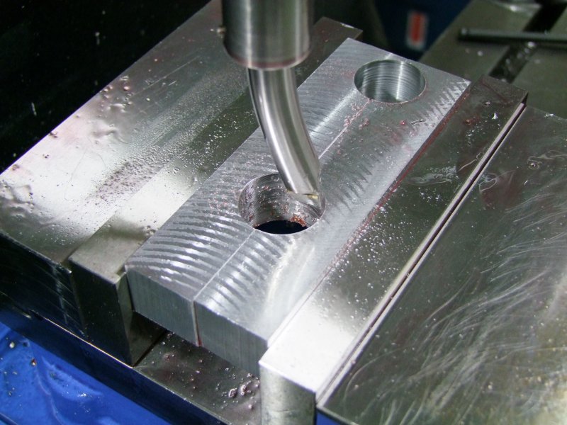

Still not done, but got the jaws drilled/counterbored today:
De-burred both ends of the hole by hand (Al is so soft!):

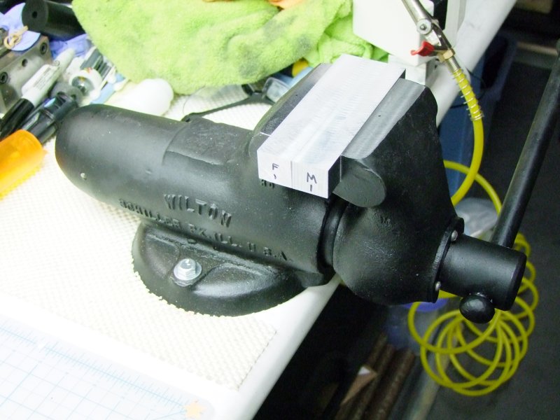

Finished (for now) soft jaws:

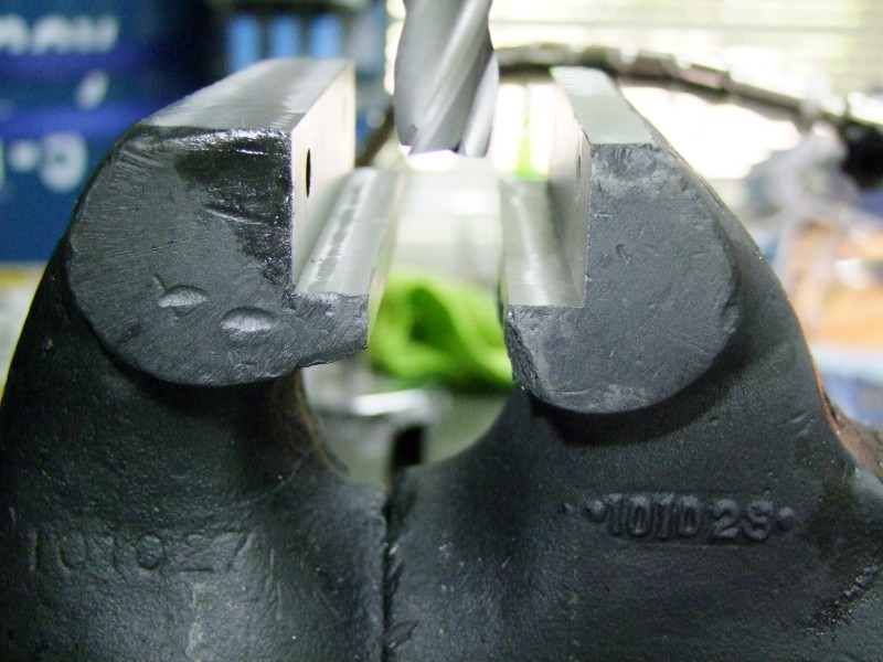

Next step, mark, drill, and thread the iron jaws (fixed and mobile):
Edit October 12, 2011

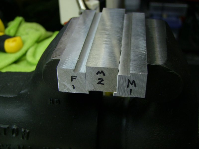

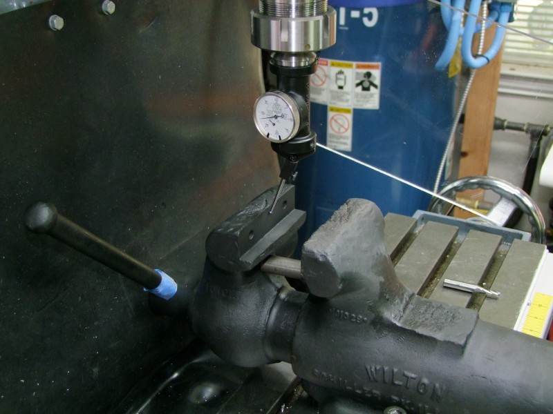

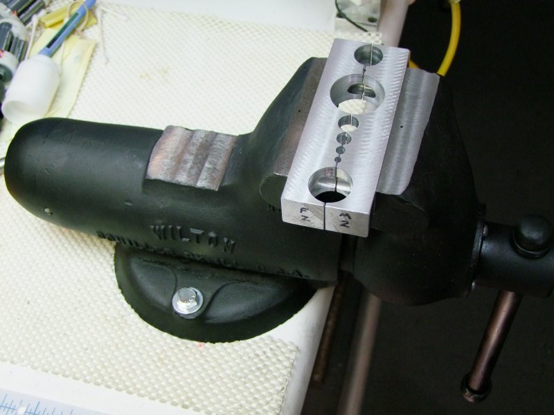

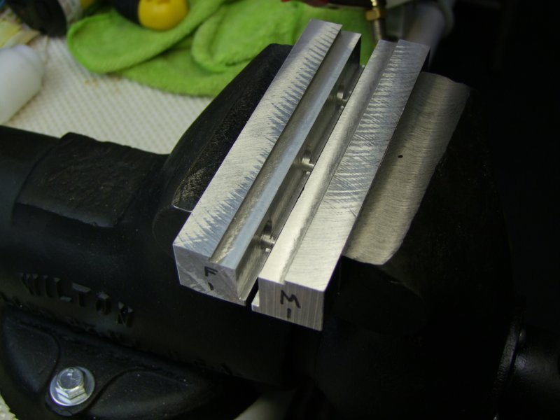

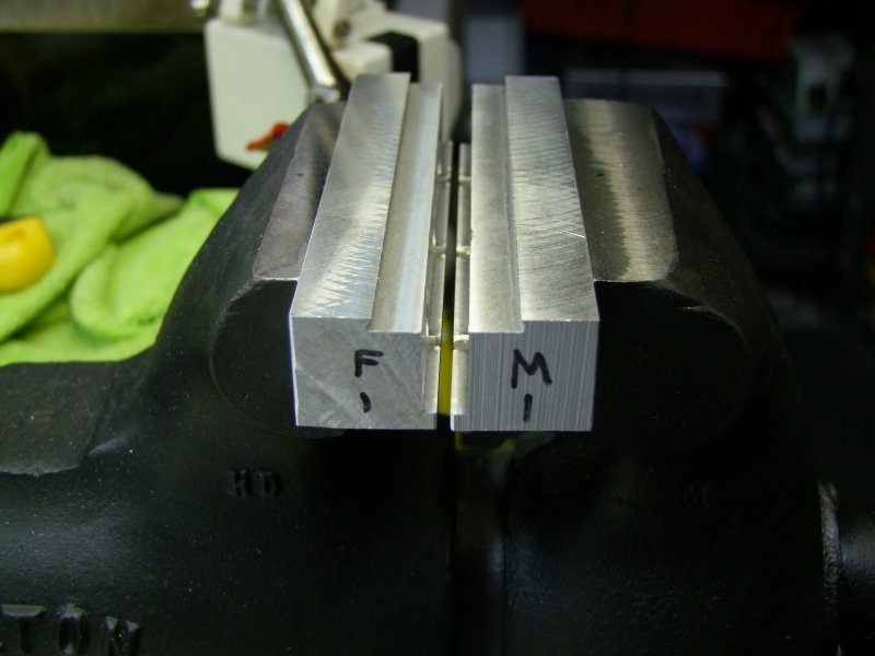

Last night I spent a little bit of time getting the soft jaws installed:
Mounted, but not quite "ready" yet :devil:

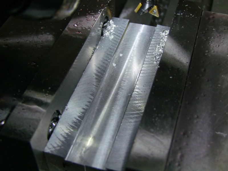

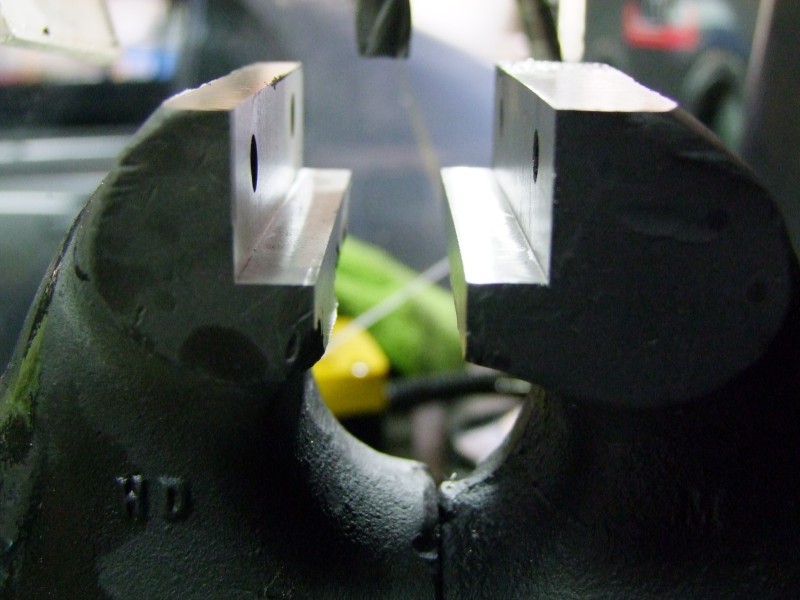

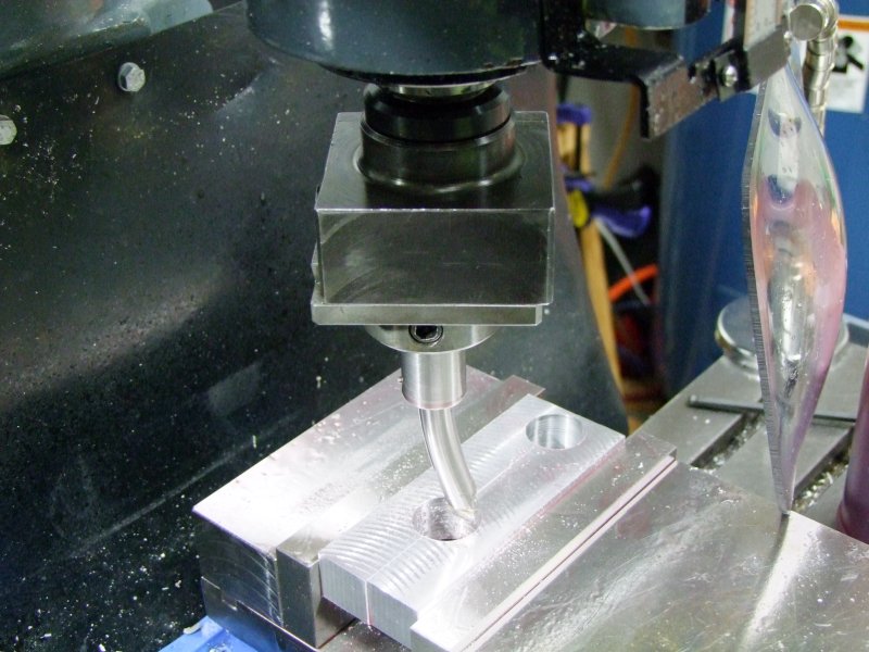

Take the two jaws to my Kurt vise, and center the Y axis:
First make a cut about 0.1" deep:
Then use the dovetail cutter:
I still need to file the sharp edges and round the corners, but this first set of soft jaws is now ready:

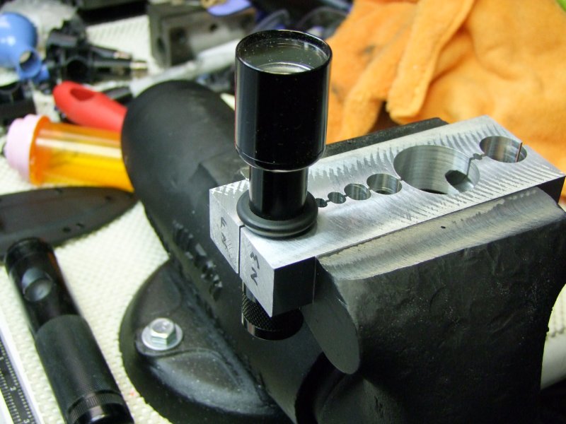

And in use:
Edit Oct 14, 2011:

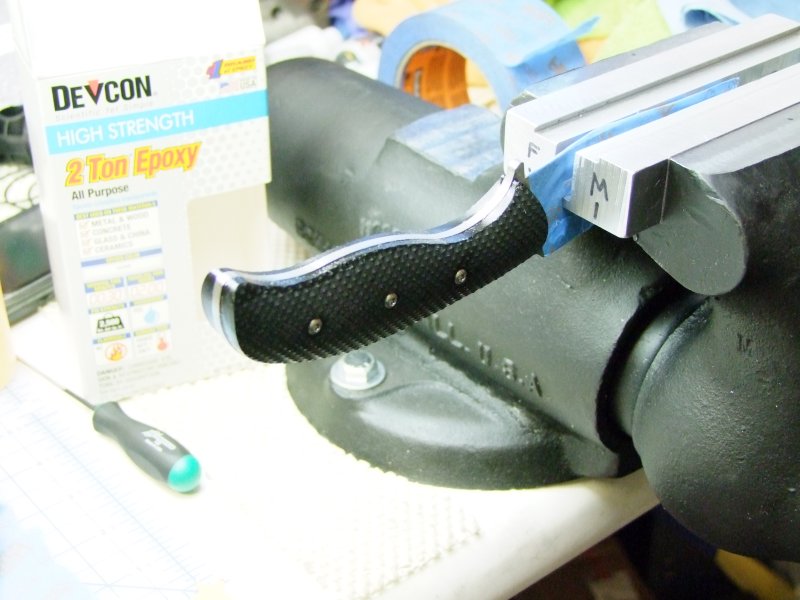

Today I finished the second set of soft jaws:

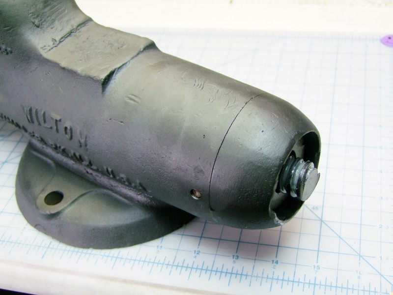

I also put two o-rings at each end of the steel bar, and now there is no metal hitting metal even when releasing it from the highest point:
EDIT: Oct 15, 2011

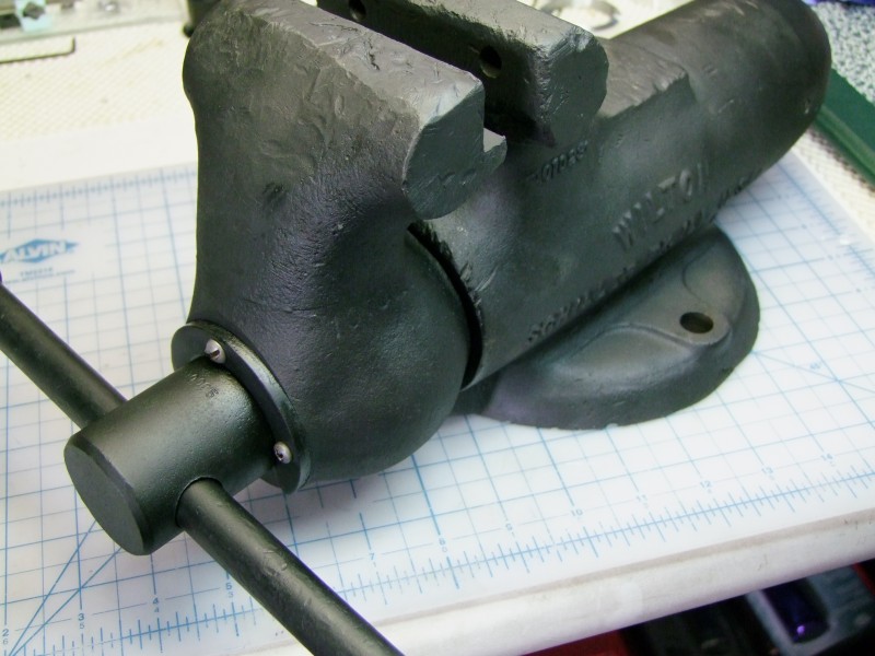

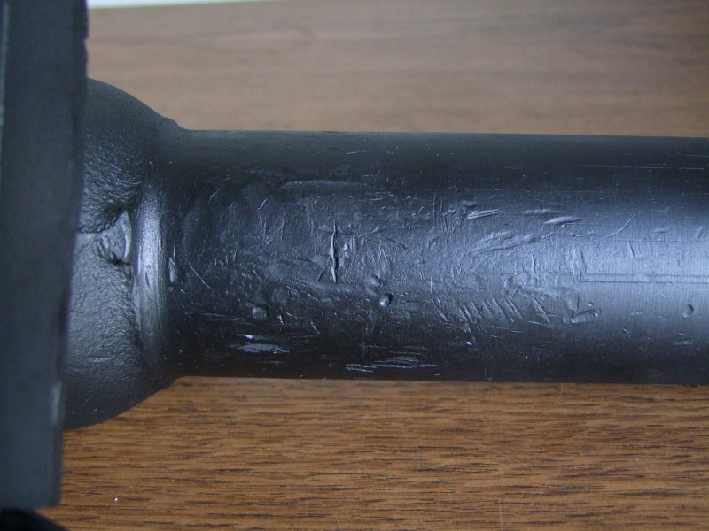

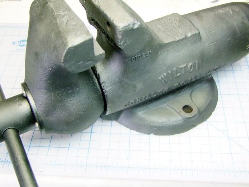

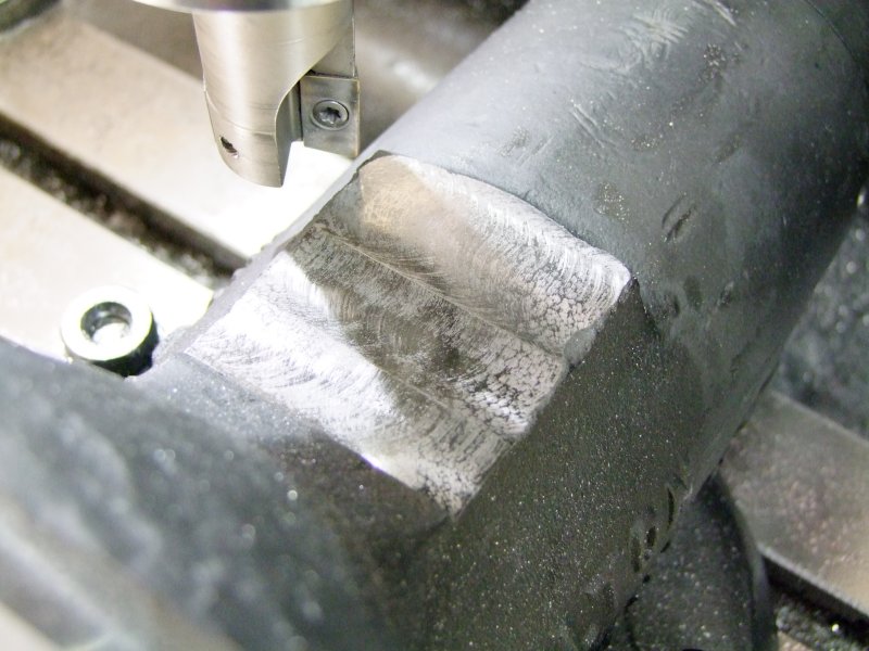

OK, last operation on the vise completed today. I still need to fabricate a cap for the rear of the vise, but no more machining/restoring to the vise itself is needed !!!

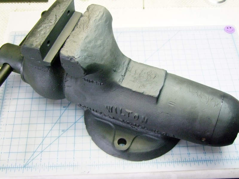

I first took like 0.020" of the top of each soft jaw, so that the engagement would happen more toward the back of each cutout - very little, but worth doing so that parts get in/out a little bit easier:
So as I was saying this is the last operation - to smooth out and make flat again the back of the vise - the "anvil" part:
And ready for maybe another 20-30 years of use :D
