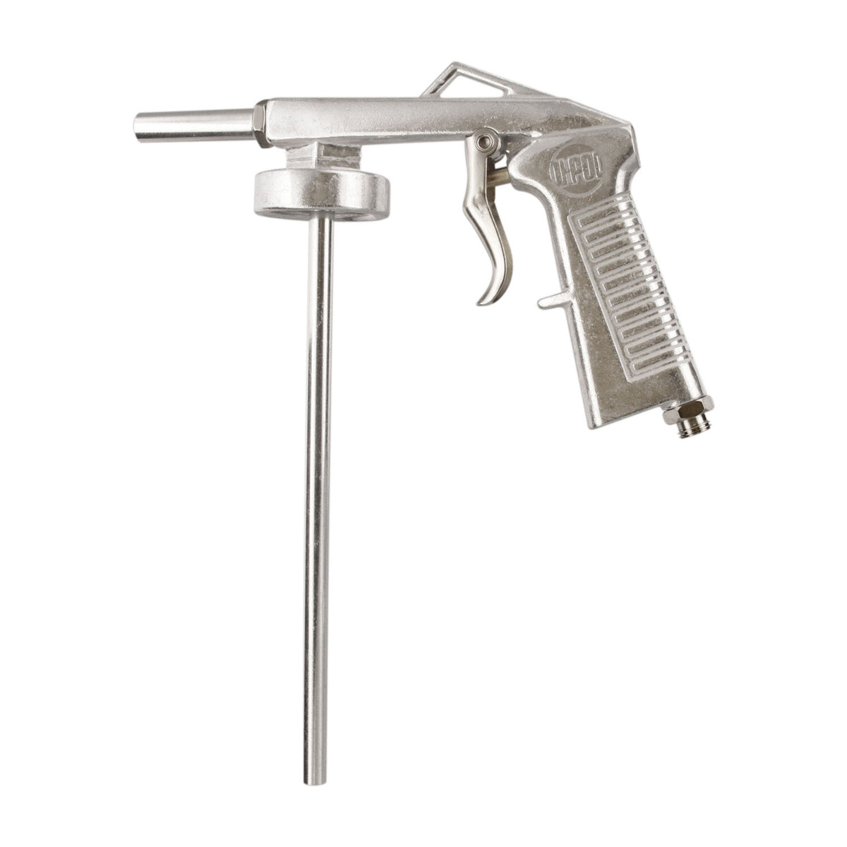

Get yourself a "schutz" gun and experiment with various coatings. I have used simple roof patch, thinned a bit, in places like interior walls of car trunks, etc. It sets up fast and can be painted . Results looks much like your picture.
