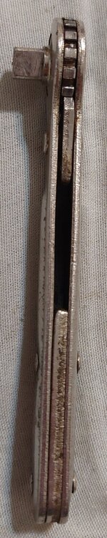

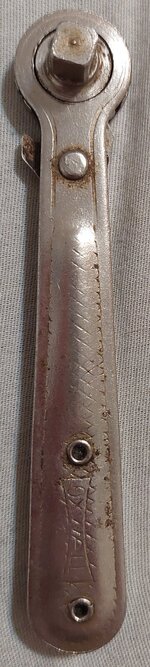

Meteor, Oxwall, GM Co. were sort of the "big three", I guess you could say of low end US made tools. Although they also imported from Japan and West Germany. Great Neck could also be considered one, although they did make some tools that could be considered borderline high end.
Here's an 1/4 oxwall ratchet. It has 16 teeth although it feels more like 1.
