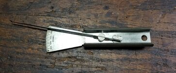

Okay I may need all the Bell braintrust (@Cooter Brown and @NYBODYMAN and @southalabama etc etc) on these....
They are not marked Bell System or Western Electric, but I strongly suspect that they are, just from the branding. Some of you may remember I have a US Army Signal Corps Buckingham lineman's belt and Buckingham climbers and they were well-known vintage Bell/WECO suppliers. I am guessing they're quick gauges. The various slots have markings "ML ->", "MW ->", and "MT ->" pointing to the various slots, which suggest something like measure length, width and ? to me.
Hoping someone knows before I have to hunt through the catalogs.

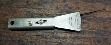

I pulled those out of the same box as this at the flea market this morning, and while this is also not marked, I know for sure it's a Bell or Weco spring scale for measuring the tension in contact springs, as in old relays and similar electrical apparatuses. I am also attaching the patent, which referred to it as a Spring-Tension Gauge.

Those gauges are used for ensuring climbing gaffs are dimensionally okay after sharpening. MT is maximum thickness.
30,454
@BrandonV
Using the Telcom Archives index now handily posted in post #1, I found a C Gaff Gauge in a 1957 BSP manual, with explicit instructions on measuring for L, W, and T, but it's different than the gauges I have here. I'm wondering if mine were earlier, later, or just different. The 1975 and 1976 BSP manuals for climbers do not include a Gaff Gauge. Interesting read. See Section 3 and 4 in the link here: https://telecomarchive.s3.us-east-2.amazonaws.com/docs/bsp-archive/G/G80/G80.801.3_I2.pdf

Earlier. I would put them in the 1940s.
Looks like a 6106.

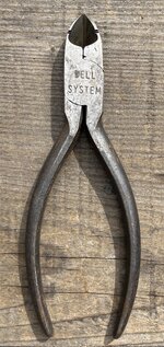

Judging by the many phone company tools I saw during my two visits to an Orinda, CA estate sale, the previous resident worked in that field. I found these during my first visit. The top tool’s use is explained upthread in posts 455 and 465. The same tools were posted by Out of Bounds and Mintgrun.IMG_1608.jpeg

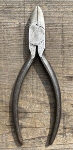

Posted this on the Pliers Thread last week. Took some more pictures. Did some more Bell System Practices Rabbit Hole Diving. Still know nothing about ‘em.
  • Lindstrom.
  • Bell System.
  • 19+ inches long.
  • Stamped-in “59”.
  • One handle bent.
  • IF modified, it would have been done at about the 4 1/2 inches point, but it’s not obvious to my untrained (and aged) eyes.
  • Compared them to smaller Lindstrom we have.

Found it:
JMP
Jul 6, 2024
398
"(P)liers for general use." Uh . . . general use?
You are obviously the Rabbit Hole Diver of the Day!
It does seem funny to call them general use pliers when they obviously are not your everyday plier commonly found in a local hardware store. I suppose general in the sense that they are not associated with any specific piece of Bell equipment. The jaws are your standard generic shape yet they are of course a specialty tool with the extended reach. The Bell tool catalog I found these in omits the more generic/non-specialty kinds of tools.

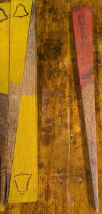

Found these in the basement of an estate sale on the second or third day. Haven't seen them since the late 60's, early 70's when Illinois Bell staked their underground lines with them in our suburban subdivision. Are the yellow ones unique to Illinois Bell?
As been said, Bell didn't scrimp on tools, and they didn't scrimp on these stakes. They're made of oak! They don't make them like this anymore!PXL_20250520_210826742.jpg
