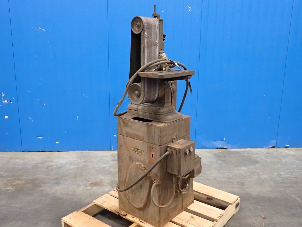

Picked up this powermatic last year for 200$, needed some loving but it's 1 1/2 hp 3 ph running off a vfd gives nice speed control & has a built in dust collector.
Thats an awesome deal! SCORE...3 phase kinda ***** but I do have a phase converter.
Dammit I wish I had seen this one earlier than I did Matt.
That's a beast. A real machine. Dang it, I thought the Dickensheet auctions usually ****. I'll have to start watching them as well...

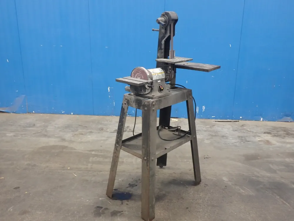

My homebrew 6x48 fell while moving and broke parts of the casting. I haven't yet looked to see if it's repairable.
If you're still looking for one Matt I found the attached Rockell/Delta (same as the Wilton) belt/disc at an estate sale to replace the one that fell. You're welcome to take a look at the broken one and see if it can be brazed for a repair if you're interested. I can get pictures and send them to you.

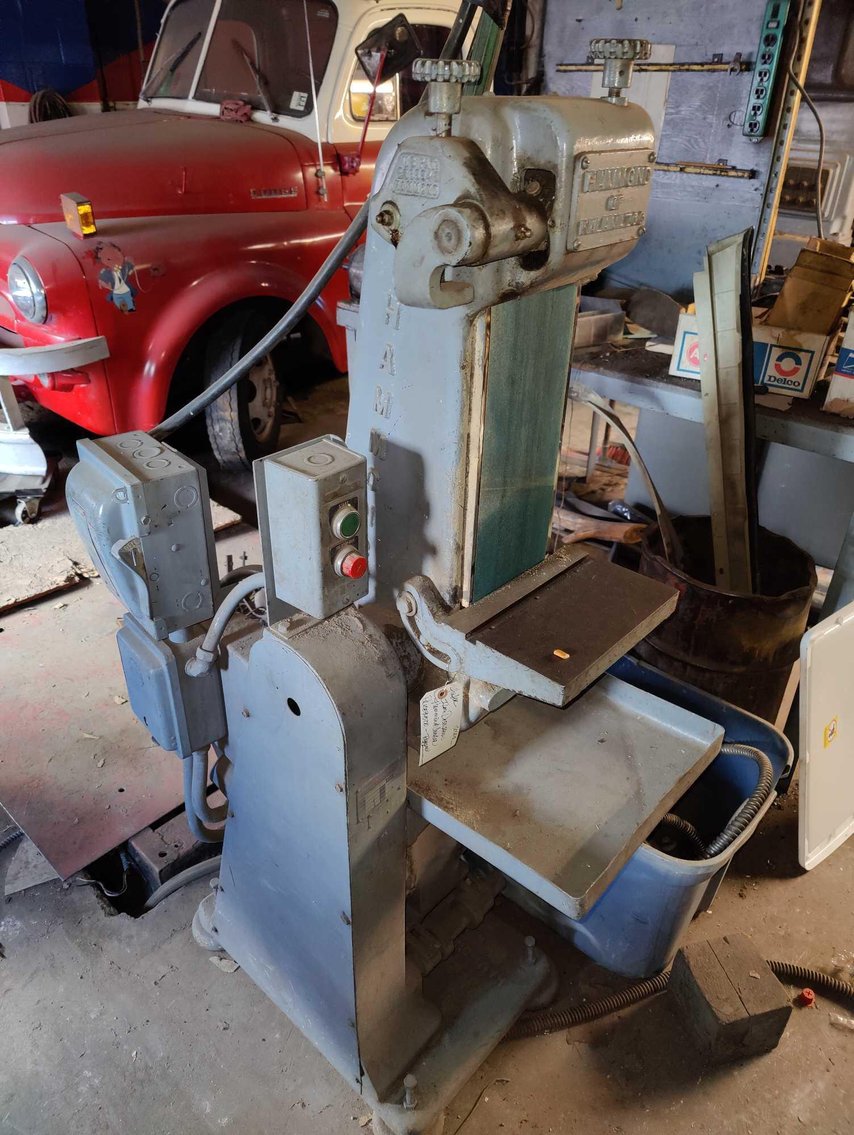

I prefer the old cast iron domestic stuff…I found this Rockwell combo on CL, was a real dumpster fire but cleaned up well…still searching for a fence/table (anyone got any leads?) for the belt portion…Tool will out live me if treated half way decent...

Svtride I’d love an older unit as pictured. I do believe they are better built. But I have yet to find a good candidate close enough to be worth it.
